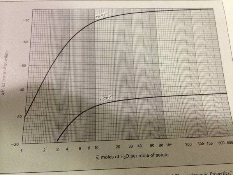

Here is my attempt with a relevant table and graph, but I wonder if my net equation represents the situation and if my intermediate reactions are okay. I just made the intermediates arranged to get the final equation the way I wanted. I can't really say how every intermediate reaction is representing the physical situation

I don't think you have to care about whole Hess cycle. Why don't you read heat of dissolution (from the plot) for both solutions as if they were prepared from water and anhydrous LiCl, and just subtract one from another?
