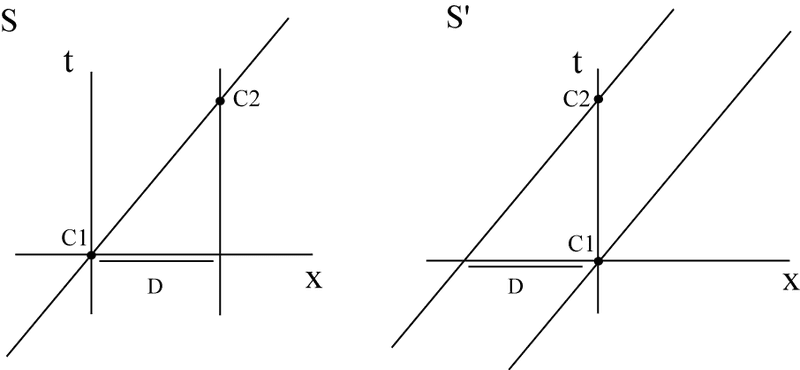

Indeed! and thank you for all your answers. The attached diagram may be clearer than my questions. C1 and C2 are the crossing points with the two planets, on the left in the frame of an inhabitant of planet 1 and on the right in the frame of the astronaut. Is the distance marked D the same for both points of view or not?
(The angled lines in the right-hand diagram should slant the other way, southeast to northwest).
In the left-hand diagram D is the distance between the planets using the frame in which they are at rest. In the right-hand diagram D is the rest length of the rod. There is no particular reason for those to be the same unless we chose the rod or placed the planets to make it so. Neither D is related to any contracted length.

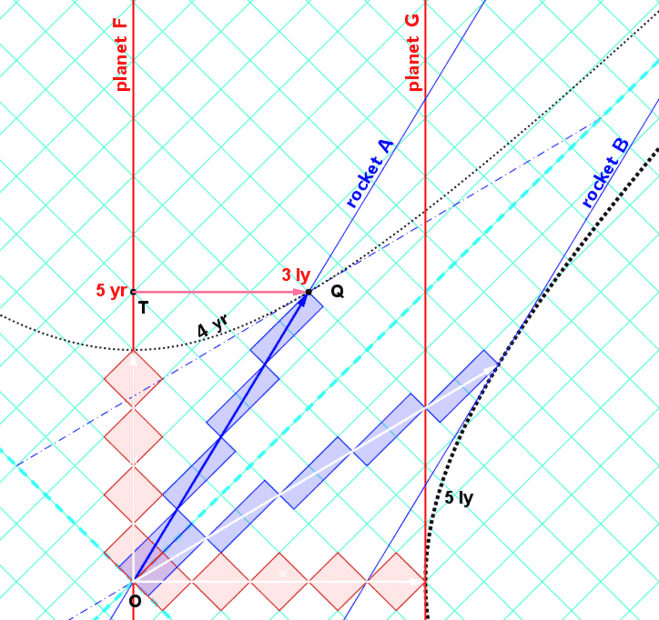

Here's the spacetime diagram that I suggested in #2.
In the rest frame of the planets,
their separation (the spatial-distance between the red worldlines along the red dot-dash line) D is 5 light-years. (There is a hyperbola [analogous to a circle] representing 5 spacelike-units.)
An inertial astronaut (Bob) traveling at velocity (3/5)c measures a
a smaller separation (the spatial-distance between the red worldlines along the blue dot-dash line)... smaller because the dot-dash segment doesn't meet that 5-light-year hyperbola.
This separation for the case with numbers given here turns out to be only 4 light-years.
Numbers are less important.
First should be on the fact that
the measured separation is smaller
(for relative-motion along the extent of a long-meterstick between the planets).
What is key is how the inertial astronauts define simultaneity
(by the tangency to the hyperbola at the point-event where the astronaut worldline meets the [future-timelike] hyperbola [analogous to a circle] representing (here) a spacetime-interval for 4 timelike-units).

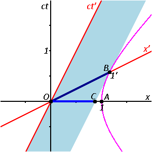

No. In addition to what the others answered:
In frame S' (rest frame of the rocket), the (length contracted) distance between the planets is ##D \sqrt{1-v^2/c^2}##.
You assume that the rod at rest in frame S' has the same length ##D \sqrt{1-v^2/c^2}##. The two ends of this rod each meet a planet at the same time ##t'##.
This rod is even shorter by length contraction in frame S: ##D (1-v^2/c^2)##. But in frame S the two ends of this rod meet planets at different times ##t##. So in frame S the length of this (moving) rod is not equal to the distance of the planets.
Source:
https://commons.wikimedia.org/wiki/File:Animated_Spacetime_Diagram_-_Length_Contraction.gif

Here are some more descriptive spacetime diagrams
using "light-clock diamonds", which have equal areas
(in accordance with Lorentz invariance).
Note that when ##v=(3/5)c##, then ##\gamma=\frac{1}{\sqrt{1-(v/c)^2}}=\frac{5}{4}##.
More important for drawing these diagrams is that the Doppler factor ##k=\sqrt{ \frac{1+(v/c)}{1-(v/c)}}=2##, which are the stretching and shrinking factors that relate the blue diamonds to the red diamonds.
The following diagram can be constructed by hand from the previous one.
But, with practice, the information in this diagram can be read off the previous one.
