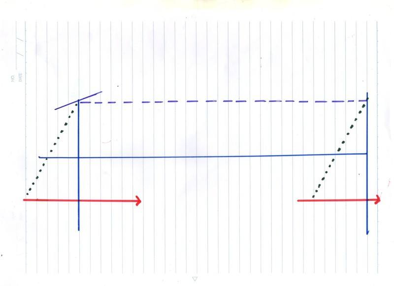

@morrobay - as requested, I had a re-read of this. I'm rather confused by your experimental design. Where do you have clocks? You refer to clocks in S and S' being started and stopped by flashes of light. Where exactly are these clocks? One on the rocket and one each at the start and end markers of the course? Where is the light flash emitted from? The rocket, or one or other of the course markers?
I initially interpreted your setup as having one clock on the ship and one on each marker, the latter two synchronised in the Einstein sense. Then you measure the transit time in S using the difference in clock readings on the two marker clocks when the rocket passes, and in S' using the elapsed time on the rocket clock. But now I think you are using light flashes in a more complex way, and their travel time may need to be factored in.
Also, in #10 you have started referring to proper time. Proper time is often called "wristwatch time", because it is the elapsed time on your personal timekeeping device. But that means you need to say that whose wristwatch you are talking about and the time between what events on their worldline. Since you specified only two events and everything is inertial there can be only one proper time between them.
I'm not saying your conclusions are wrong, just that you need to set out your experiment with more care so that we can follow what you are trying to do. Perhaps a diagram?
(1) Rocket , v = .6c left of origin, (vt1 )2 = (ct1)2 - (ct2)2 sends light flash to mirror in S. Rocket clock starts at x = x' = 0.
Reflected light travels to clock in S at x = 1000m marker. This clock pre. advanced . by d/c starts.
(2) Light flash from rocket left of x = 1000m by (vt1)2 stops clock in S frame as it passes 1000m marker when rocket clock is also stopped.
The elapsed time in rocket clock Δt' = Δτ' is 800m/.6c
The elapsed time in S frame is Δt = Δτ = 1000m/.6c
I think I understand what you are trying to do now. You are trying to measure the rocket's travel time in S using a single clock and without having to worry about the relativity of simultaneity. Right? If not, I still haven't understood what you are trying to do
If so, it's impossible. If it were possible then there would be an absolute sense of simultaneity and you'd break relativity. On a more concrete note, why did you choose to advance your second clock by d/c? The answer is because you assumed that the one-way speed of light was the same in both directions, which is equivalent to adopting Einstein's synchronisation convention.
The time you call Δτ is the proper time of the second clock at rest in S between an event on its worldline simultaneous (in Einstein's sense) with the rocket passing the first clock and the event of the rocket passing the second clock.
Yes I was measuring travel time in S,Δt ,with one clock located at x = 1000m. Light flash from rocket strikes mirror when rocket passes origin .( see diagram) light then starts clock with photo cell at x = 1000m in S frame. Since that signal is not instantaneous the clock at 1000m must be advanced by 1000m/.6c in order to measure travel time from t0 to t1 when rocket passes x = 1000m marker
You have said this is not possible. So then how would observers in S start and stop the clocks in accord with simultaneity that would be in agreement with calculated travel times :
Δt = 1000m/.6c = 5.5 ⋅ 10-6 s
Δt' = γ ( Δt - vΔx/c2)
Δt' = 6.94 ⋅ 10-6 s - 2⋅10-6 s = 4.94⋅10-6 s
Edit: Δt' = 6.94 ⋅ 10-6 s - 2.5⋅10-6 s = 4.44⋅10-6 s
That is apprx Δt/λ , .8 ( 5.55⋅10-6s) = 4.44⋅10-6 and also
= 800m/1.8 ⋅ 108 m/sec
Then Δt' also equals Δτ'
You misunderstand me. Your methodology works fine. But it is not independent of the relativity of simultaneity, which is what you seem to be claiming in #7. That comes into it through your choice to pre-advance your clock by d/c, which is equivalent to starting it at zero at the same time as the light pulse leaves the start marker (i.e. simultaneously in the Einstein sense).
So your methodology measures the coordinate time in S between the events "rocket passes the start marker" and "rocket passes the end marker". This is also the proper time of the clock between the events on its worldline "simultaneous with the rocket passing the start marker" and "rocket passes the end marker". But since the starting event is chosen using some simultaneity criterion, that proper time doesn't have any particular significance.
