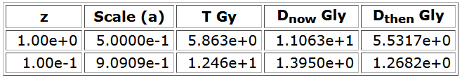

You can obtain those values from the calculator, I think, but not directly. Since these are still points on the same lightcone, all it takes is to call the outputs for the desired redshifts, like so:
Table with columns z, Scale (a), T Gy, Dnow Gly and Dthen Gly, listing two rows: z 1.00e+0 with values 5.0000e-1, 5.863e+0, 1.1063e+1, 5.5317e+0; and z 1.00e-1 with values 9.0909e-1, 1.246e+1, 1.3950e+0, 1.2682e+0.
Then deduct the corresponding distances and multiply by the scale factor at reception (Dnow) or emission (Dthen).
E.g.
##D_{now1-0.1}=(D_{now1}-D_{now0.1})*a_{0.1}=(11.063Gly-1.395Gly)*0.90909=8.789Gly##
the remaining discrepancy likely coming from rounding errors.

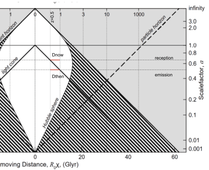

The conformal diagram shows best what is is being done here:
Conformal diagram of the universe plotting scale factor a against comoving distance in Glyr, with light cone, particle horizon, Hubble sphere, and the z=0.5 line marked with Dnow and Dthen distances.
The observer sits where the z=0.5 line intersects the lightcone. After subtracting the comoving distances between different z's, we need to multiply them by the appropriate scale factor at a given time to get the proper distances.

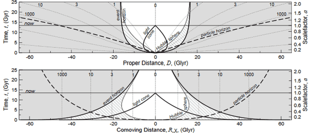

When you ask the calculator to draw the D(now) vs the cosmic time, you may recognize the shape of the light cone as the second one here:
Two stacked cosmology diagrams plotting time (Gyr) against distance, with a scale factor axis on the right; dashed and solid curves mark the event horizon, particle horizon, light cone and Hubble sphere, with dotted redshift contours labelled 1000, 10, 3, 1 and 0.
(from Lineweaver&Davis 2003)
I.e. it plots a comoving distance vs time. The first one is the same as D(then) vs time, btw.

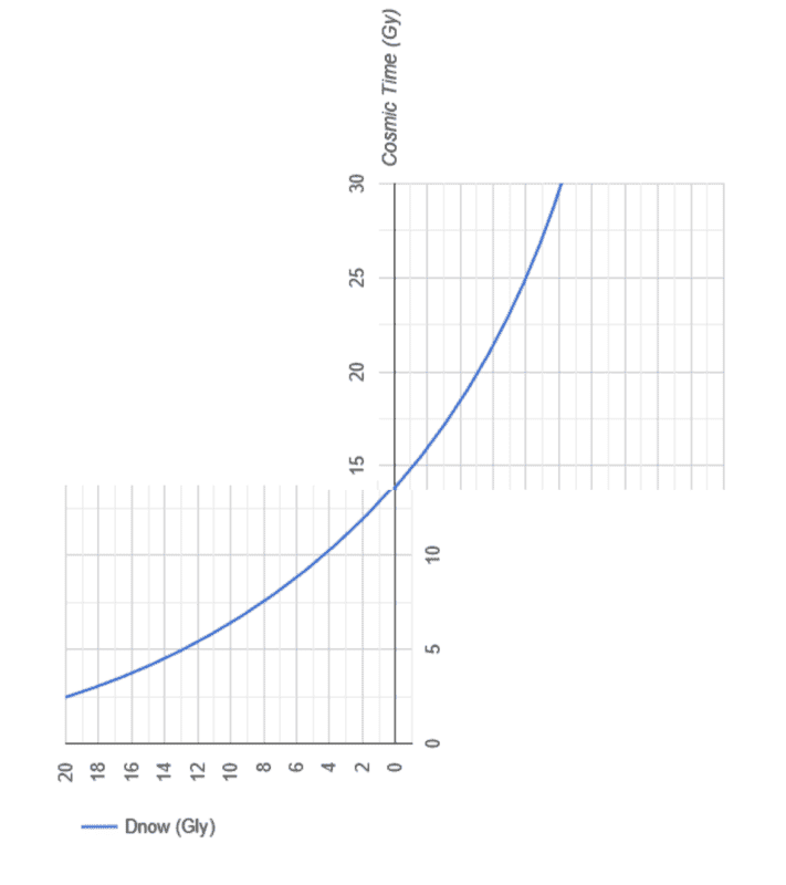

If you call the D(now) graph on the calculator, you get something like this:
Line graph titled LightCone7 Chart: Dnow (Gly) against Cosmic Time (Gy). The curve falls steeply from above 20 at about 2.5 Gy to 0 near 14 Gy, then rises more gently to about 10 at 30 Gy.
The 'reflection' here being just due to how the graph uses only the positive values for distance. There is no negative side of the distance axis. What it actually shows, is this:
Graph of Dnow (Gly) against Cosmic Time (Gy), with the curve rising from the lower left to the upper right through a vertical axis at time zero; the graph is rotated, with distance on the horizontal axis (0 to 20) and cosmic time on the vertical axis (0 to 30).
That's because the light cone continues past the observer. I.e. we ask what is the distance between the emitter of a signal we observe now, with a given z, and the receiver of the same signal in the future, who will see it with some other z.
When one asks what is the distance between two points(1,2) on the left hand side of the 0 axis, one gets ##\lvert{D1-D2}\rvert##. When the second point is on the right hand side of the graph, the total distance ends up being a sum, not a difference.

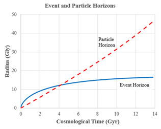

I am lost. Shown below is a plot of particle horizon vs. t and event horizon vs. t. Both horizons have value 0 at t=0.
Graph titled Event and Particle Horizons plotting radius in Gyr against cosmological time in Gyr from 0 to 14; a dashed red particle horizon line rises steadily, a solid blue event horizon curve rises quickly then levels off near 16 Gyr, both starting at zero.

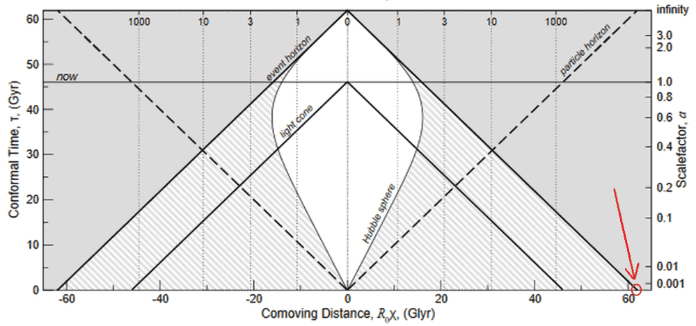

OK, look - in general, to get proper distance to any event whatsoever, you can always multiply the comoving distance to it by the scale factor at the time you're interested in. That's what we did before with the distances between observers.
Here, we can take the comoving distance to the event horizon, ##D_c## and the scale factor as our variable. So, ##D_p=aD_c##. The problem is, of course, that the ##D_c## is time-variable.
But, since you're interested only in the earliest times, with z ranges below 20000, we only need a tiny fragment of the ##D_c## slope, where it's almost constant. I.e. we only need this bit:
Conformal diagram of the LCDM universe with conformal time on the vertical axis and comoving distance in Glyr on the horizontal axis, showing the event horizon, particle horizon, light cone, Hubble sphere and labelled scale factor and redshift marks.
Where above z=20000, the ##D_c## varies only between ~61-62 Glyrs (or 63, whatever the actual value is in LCDM), while the scale factor is changing by orders of magnitude, dominating the result. So for a not-bad approximation, you can assume ##D_c## to be constant*, and pick the maximal value it had at t=0. Which is the same value as that of the comoving distance to the particle horizon at infinite time, as the graph above shows.
*(over this range only; of course it will fail spectacularly if you try to graph it over the remainder of the cosmic time)
To be clear, it's no different than taking the graph you posted in #12, and tacking on a straight line from the edge of the R(event) curve to zero. The argument for its use is that for the earliest times, the missing bit of the slope is really not that much different from a straight line.
