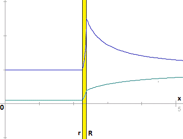

We have talked about black hole, Unruh and cosmological horizons in these forums...I am wondering if a simple example [thought experiment] might usher in an introduction to such rather abstract horizons:
the sphercial hollow shell of matter...from the outside, a test particle is attracted just as if the shell were a point charge; but after passing thru the shell suddenly there is no gravity...the particle is suddenly no longer subject to any gravitational attractions.
For an infinitesimally thin shell, there is a discontinuous jump in gravitational potential.
This seems to have SOME similarities to the first three horizons I mentioned...for example, as a test particle approaches the hollow shell from the outside would it not appear to slow when viewed from a distant intertial frame since some time dilation occurs...increased gravitational potential. What happens to that particle's "aging" when viewed from that same distant inertial frame inside the shell? Does time continue to "slow" for that particle, so that for example, maybe a radioactive decay would appear delayed from the distant frame?? Seems like it must...Or does it resume zero gravitational behavior??
I fear I have missed something because I have never seen such a simple example discussed as an illustration of "horizons"...
Comments,insights,criticisms appreciated.

Shouldn't that be discontinuous jump in gravitational gradient? Potential G00 (referenced to [URL]http://upload.wikimedia.org/math/3/1/8/318a357012f7ad029e2d8781eed017df.png[/URL] - hope that's correct usage) will be uniform within, but depressed wrt infinity so time dilation and length contraction apply just as at the exterior surface of the shell, I would say.
If correct, does it not seem like the distant observer in a zero gravitational potential observes time passing more slowly elsewhere, also at zero gravitational potential.

The particle is suddenly no longer subject to gravitational attractions, but it is still subject to gravitational time dilation. Stationary clocks inside the cavity are all running at the same rate, but they are all running slower than stationary clocks outside the shell.
There is a rapid change in gravitational force but it is not discontinuous because it changes smoothly as you pass through the shell. It only appears discontinuous in the limit that the shell has no thickness but in that case the shell would have no mass. It is the same for the gravitational potential gradient and gravitational time dilation. The gradient changes smoothly as you pass through the shell and becomes zero (flat) everywhere inside the shell. The potential (and time dilation factor) is equal everywhere inside the shell, but lower than outside the shell.

In the original hollow shell, spacetime is indeed flat everywhere inside and there Euclidean, but the also as you say, the gravitational gamma factor is uniformly greater inside the shell than outside, so clocks run slower and rulers are shorter than outside the shell. The radius measured inside the shell will be greater than the shell circumference suggests. It is difficult to justify the reason for the shell radius or volume being greater than the Euclidean expectation is due to spacetime being non-Euclidean, when the spacetime everywhere inside the shell IS Euclidean!
And I thought Doctor Who was just sci-fi rubbish. Silly me!:confused:
yuiop said:
... when the spacetime everywhere inside the shell IS Euclidean!
Oops! Just worked out that the space inside a hollow shell is NOT Euclidean. :redface: If an observer inside the hollow shell measures radii and circumferences, he will find that Circ < 2*pi*r which is a bit weird in flat space!
That's what I decided after my original post.
Passion flower:
The space in the inner shell has expanded that is the whole point!
The space is no longer Euclidean.
I did not even think of that when posting initially...I don't know all the math involved, but it seems this would be expected as spacetime within the hollow spherical shell must be different from that of the distant (inifinite,inertial) observer since the time, for example, passes at different rates. That IS interesting...
So is this a type of horizon??

Apart from my comments in entry #24, came across the following which to me casts further doubt on the 'non-Euclidean within' business:
Birkhoff's theorem (relativity) http://en.wikipedia.org/wiki/Birkhoff%27s_theorem_%28relativity%29" I'm no expert and may be wrong on this - will be interesting to see what washes up.
At first I assumed that the geometry inside an empty cavity would be Euclidean then later decided it was not and now I am not sure which is true but Birkhoff's theorem suggest the first conclusion. If it is true that the space inside an empty cavity is Euclidean then this would suggest that gravitational time dilation is purely a function of gravitational potential at a point and that "gravitational length contraction" is a function of the potential gradient over a finite distance, possibly explaining why horizontal rulers do not length contract (zero potential gradient) and vertical rulers do (non-zero potential gradient).
Q-reeus said:
It was while trying to put some numbers and facts to your question that I stumbled across the interesting thought experiment that became the topic of the new thread :wink:.
My understanding was the ruler would uniformly contract as a function of potential only (neglecting 'weight' effects, and tidal forces which are second derivative of potential) just as time would dilate. However your remarks in the other thread about normal vs isotropic Scwarzschild coordinates leaves me wondering how to interpret 'uniform' - which system represents what a distant observer will actually observe? I think one thing here we can agree on, since potential within the shell is uniform, both clocks and rulers will behave independent of location within that shell. Which is why I found it so hard to accept that one could obtain a non-Euclidean result where volume and area (or diameter and circumference) had other than the usual relations. That's why I thought isotropic Schwarzschild held the key, but maybe not. Even Doctor Who would balk at the notion that there can be curved and flat at the same place and time (on second thoughts, the last few Doctors have been hyper-ventilating half-bonkers types)!:rolleyes:
