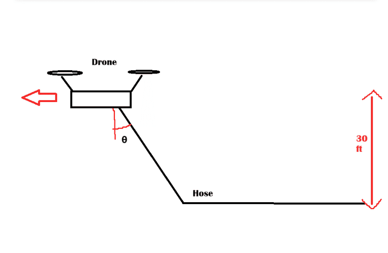

Find forces and moments acting on drone.
basic physics equations, moments, etc

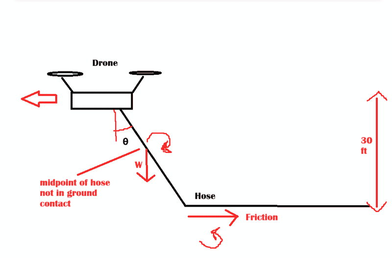

This is not technically a homework question, but it seems trivial enough that it probably belongs in this forum (and last time I posted something similar it got moved here, apologies if I have now reversed the problem and posted in the wrong forum again.) I am trying to find the forces and moments experienced by a drone. It seems very straightforward, but it's been a while since I have done any physics problems like this and I would appreciate a second set of eyes letting me know if I have overlooked something. This drone is flying at around 30 feet in the air and dragging behind it a hose.
The hose will be at some angle θ; as far as I can tell I can't calculate this without more information about the forces like thrust from the drone, but it will probably be around 45 degrees. There are two main forces acting on the drone: the weight from the hose and the friction from dragging the hose.
The weight from the hose is only the weight of the hose that is in the air. If we know the weight per unit length λ, we can multiply that by the length 30/cos(θ) to get the downward force. This force acts at the center of the hose that is in the air, so it will create a moment. The moment will be equal to the force multiplied by the horizontal distance between the CG of the drone ad the point where the force acts: in this case, that will be 30*tan(θ) (plus and distance from the hose being mounted away from the drone CG but I will assume that is 0 for now.) So the moment caused by the weight of the hose is M = λ*(30/cos(θ))*30*tan(θ) (clockwise.)
The force of friction is the weight of the hose still on the ground multiplied by a friction coefficient μ. If the length of the hose on the ground is L and the weight per length is still λ, the friction force is μ*λ*L. The moment caused by this force is 30* μ*λ*L, and this time it is counterclockwise.
Hopefully a question this trivial doesn't bore anyone to death; I just want to be absolutely certain I haven't overlooked anything since this is for a real life project. Thank you!
Do we know the total length of the hose, counting both the portion on the ground and the portion in the air? I assume that this length is fixed. So we are not unreeling hose from a spool. I assume that we are looking for an equilibrium situation, dragging the hose over the ground at a fixed speed.
You do realize that the portion of the hose in the air will not be in a straight line? It will have a different angle at the drone end than at the ground end.
Can you see what the angle at the ground end must be?

The total hose length is 150 feet. Yes, I was assuming equilibrium motion, sum of forces = 0.
I do realize that the hose would sag slightly rather than form a straight line. I assume the angle at the ground end would approach horizontal. I was approximating it as a straight line because I wasn't sure how to calculate the shape it sags to, and since its being pulled taut I figured it would be fairly close to a straight line. If there is a way to calculate the exact parabolic shape it takes, I have not thought of it, but I would love to know. Thank you!

I am not sure I understand, I want to know the moments so that I can avoid potentially flipping the drone.
Then you need to consider exactly how each force acts on the drone.
The lift force, presumably, acts up and to the left, through the centre of the rotor.
Gravity through the centre of mass of the drone. Drag, roughly likewise?
Tension, down and to the right, through the attachment point, which is surely below the mass centre.
Not apparent to me how it could flip except by wind gusts, but maybe I'm missing something.

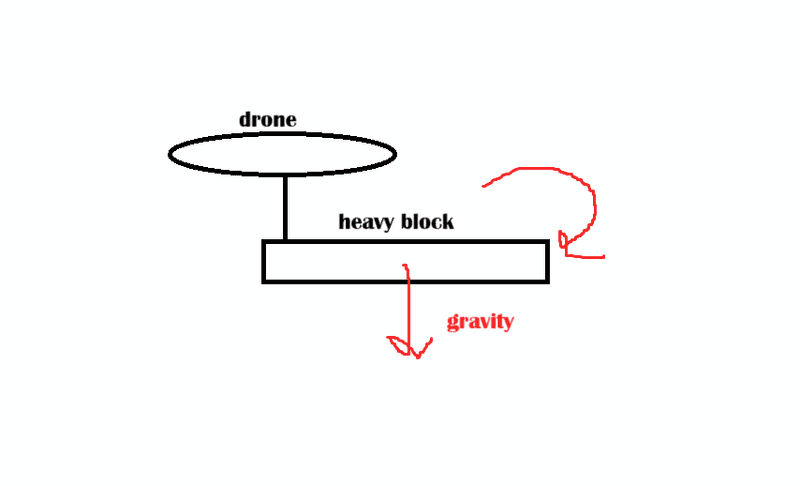

Wouldn't the weight of the hose cause a moment that could rotate/flip the drone, since it isn't acting through the drone's CG? If I attached some heavy cargo like this
that would surely cause to drone to rotate. Is the hose situation different? Am I misunderstanding what you're trying to say?
EDIT: realized my mistake was not considering the difference between a hose, that only pulls in tension, and another rigid body like the picture above that is fixed to the drone. So if I want to find the moment caused by the hose, I need to find the tension in the hose that is caused by the weight and the friction forces. Seems obvious now but I have a tendency to overlook things like that :p

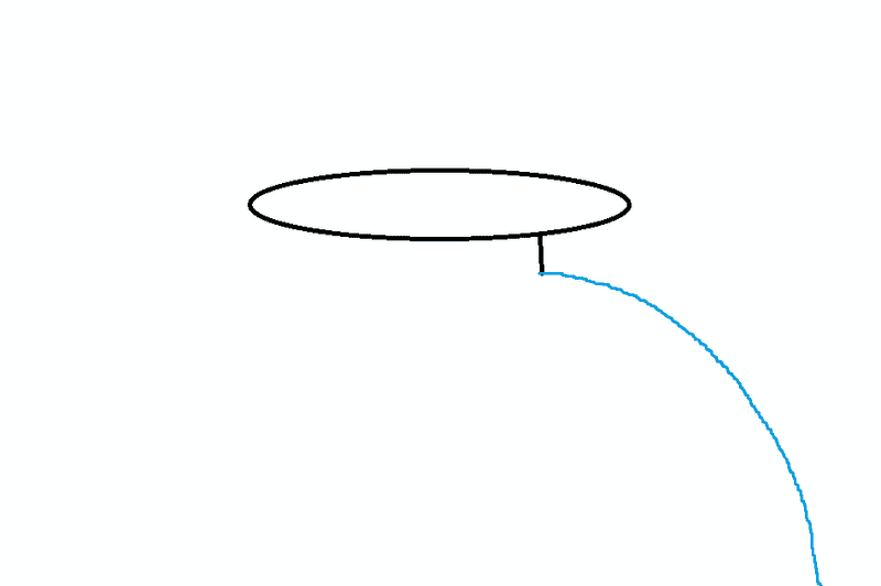

Yes, the hose has to be offset slightly towards the back of the drone. So if I want to find the moment, I need to find the tension in the hose and use that for the force the drone experiences (outside of aerodynamic drag/thrust)... yes? That leaves me with another question. Say I have a setup like this
where the hose starts off horizontal but quickly gains an angle. What direction would the tension force act? Surely it wouldn't be horizontal, although that's how it is attached, it makes no physical sense. Would it be at something like the average angle of the hose? EDIT: or could it be the resultant of the two forces that are acting on the hose (weight and friction)?
The drone-hose connection must be free to rotate in all directions.
No moment should be transferred to the flying machine, which should remain more or less horizontal, while the hose changes angles as needed.
The closer the anchoring point can be to the CG, the less power you will waste to compensate for unnecessary pitch or pitch down induced by an off-set pulling force from the load.

I do not think I understand what you're saying here. You say no moment is transferred from the load, but then talk about the pitch caused by the load, which is a moment. Is there some terminology difference I am not comprehending?
I wrote that no moment should be transferred from the load.
The less, the best.
There are two things that you could do about that:
1) Avoid a rigid connection, so your drone only has to pull.
2) Make the direction of the purely pulling force of the load go through the geometrical location of the center of lift.

Thank you! A follow-up question if you don't mind: if I avoid a rigid connection, will the force on the drone caused by the tension in the hose be equal to the combination of the forces acting on the hose? For example, if the two forces on the hose are 5 lb caused by gravity in the -y direction and 3 lb caused by the friction of the hose on the ground in the x direction, will the drone also experience 5 lb in the -y direction and 3 in the x direction, acting at the point the hose is attached? Or does it not work like that, since the hose isn't a rigid body? (I have only worked with rigid bodies in my physics courses.)
Regardless of whether the hose is rigid, we are assuming that it is in an equilibrium state. Therefore, its shape is unchanging. No incremental bit of the hose is under any acceleration.
Accordingly, the sum of all forces acting on the hose aside from the force at the attachment point must be equal and opposite to the force at the attachment point.

It is unclear what sections or joints in your diagram are rigid.
A rope can only transmit tension tangentially to its shape. If the blue line above is flexible then yes, the force it exerts on the black vertical rod is horizontal.
I note that more recent posts have brought up the issue of aerodynamic drag on the rope.
Ignoring wind, this will depend on the speed. In the steady state, the whole rope moves at the same speed. If we take the drag on a section of rope to be proportional to its length (in reality, it will be less for the more horizontal sections) then the drag just acts like a horizontal gravity. As a result, we still get a catenary, but tilted.
