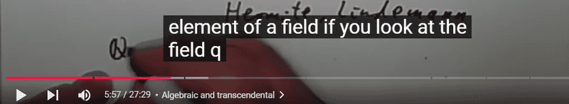

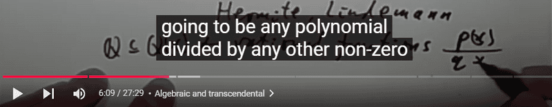

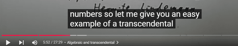

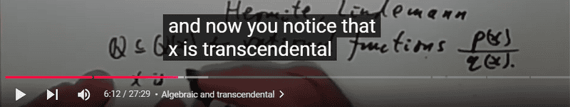

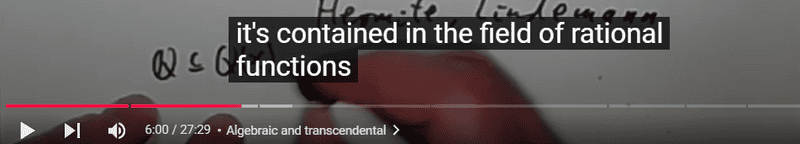

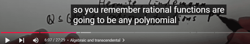

I am watching this lecture by Richard E Borcherds on Galois theory: Field extensions and the following "easy example" is not easy for me to understand.
Here it is screen-by-screen:
Screenshot of a video player showing a lecture slide with handwritten text 'Hermite, Lindemann' at top and subtitles reading 'numbers so let me give you an easy example of a transcendental', timestamp 5:52 of 27:29.
Screenshot of a video lecture on algebraic and transcendental elements, with a handwritten 'Hermite Lindemann' and a partly visible 'Q' under white subtitles reading 'element of a field if you look at the field q'.
Screenshot of a lecture video frame with a handwritten note reading 'Hermite Lindemann' and 'Q ⊂ Q(x)' partly visible, with the caption 'it's contained in the field of rational functions' overlaid.
Screenshot of a video lecture showing handwritten notes on a board reading Hermite-Lindemann and Q(e^x) and a subtitle reading: so you remember rational functions are going to be any polynomial
Frame from a YouTube lecture showing a blackboard with Hermite-Lindemann and a fraction p(x)/q(x) partly visible, with the caption "going to be any polynomial divided by any other non-zero".
Screenshot of a video lecture showing a blackboard with partly legible text reading Hermite-Lindemann and a fraction f(α) over g(α), with white subtitles reading divided by any other non-zero polynomial and now you notice that.
Screenshot of a video lecture showing handwritten text 'Hermite-Lindemann functions' with 'Q ⊆ C' and a fraction p(x)/q(x), captioned 'and now you notice that x is transcendental'.
Handwritten lecture board: Q ⊆ Q(x) with x transcendental over Q, showing the rational function p(x)/q(x) and the caption 'over the field of rational numbers' overlaid on a video frame.
How should I notice that x is transcendental?

Transcendental numbers are defined as irrational but not being in any other subset of irrationals.
Trancendental numbers are irrational with non-repeating, and non-terminating decimals but not algebraic like the ##\sqrt{2}## ie they can't be expressed as the solution to:
##(x^2-2)=0##
##x## is transcendental if it is not algebraic. Algebraic numbers are those which are a root of a rational polynomial, and there is no polynomial ##p(t)\in \mathbb{Q}[t]## such that ##p(x)=0.##
Why
fresh_42 said:
there is no polynomial ##p(t)\in \mathbb{Q}[t]## such that ##p(x)=0##
Hill said:
So, where is an example of a transcendental number in this?
If you consider ##\mathbb{Q}(x)## the field of rational functions, i.e. the quotient of polynomials in ##x.## It is the same field as if we adjointed ##\pi##
\mathbb{Q}(x) \cong \mathbb{Q}(\pi).
The only difference is, that we need Lindemann's proof to see that ##\pi## is transcendental whereas an indeterminate is transcendental per definition of an indeterminate as a variable that does not fulfill an algebraic equation.
Read carefully, he doesn't say transcendetal number. He says that ##x## is transcendental.
