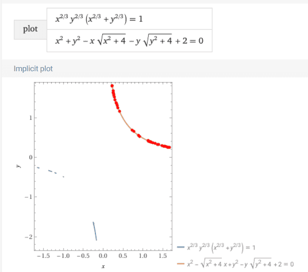

By wolfram alpha with limited resource
Implicit plot made in Wolfram Alpha: two equations are shown, and the plot has a red-dotted curve in the upper right quadrant, with blue and orange curves in the lower left, labelled with their equations, axes x from -1.5 to 1.5 and y from -2 to 1.
It seems the plots coincide for x,y>0. By algebra it is hard to understand for me that they are same.
Wolfram Alpha also says that
$$x^{2/3}y^{2/3}(x^{2/3}+y^{2/3})=1$$
has a solution for ##x>0##, given by
$$ y = -\frac1{\sqrt2}\sqrt{-x^2 - x\sqrt{x^2 + 4} - \sqrt{x^2 + 4}/x - 3}$$
Hinting at some link.
