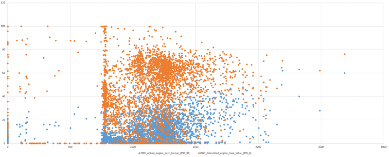

i know that it indicates the percentage of available peak torque...but when you look at the pic you will see that the correlation of them is pretty poor
