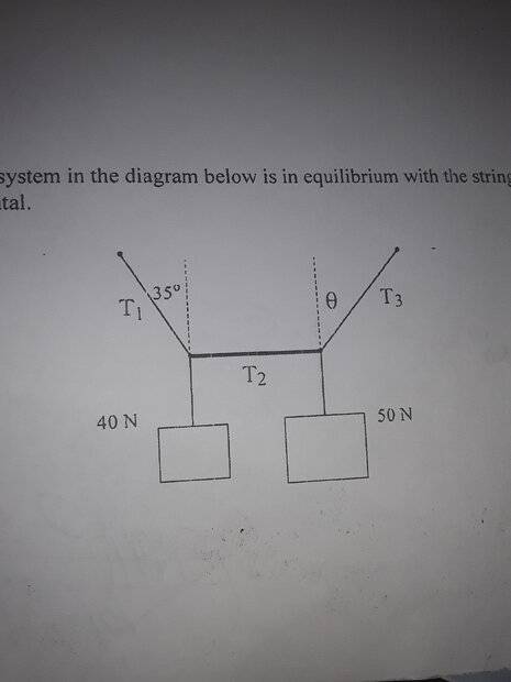

Mcmenhweilleisi
Find
Tension T1
Tension T2
Tension T3
Obtain on the left weigs 40N and on the right 50N
A few things to get you started:
Consider the piece of string in the middle and apply the equilibrium conditions for it. So it will be
$$\sum F_x=0$$$$\sum F_y=0$$ $$\sum M=0$$
So you will have 3 equations and 3 unknowns (##T_1,T_{3x} , T_{3y}##. You can find angle by ##\tan\theta=\frac{T_{3x}}{T_{3y}}##.
I think that ##T_2## will be equal to ##T_{3x}## or (##T_{1x}## ) not very sure about this.
Shouldn’t you just sum the forces on each side of the second string. 4 eqs and 4 unknowns (T1, T2, T3, θ). I have no idea what a moment means for a string
Actually, the 4 equations are decoupled. One can find T1 and T2 from the FBD of the knot on the left and then find the rest from the FBD of the knot on the right.

Well you apply the moment equation as the string was some sort of rigid body (since it is taut).
I think the two ways are equivalent, because the way I see the moment equation it is essentially a force balance equation e.g $$T_{3y}l-50l=0$$ where l the length of the second string.
Quite so.
We have one set of forces acting at one knot, and another set at the other knot.
Writing that the resultant of one set has no moment about the other knot is the same as writing that that resultant has no component normal to the string.
