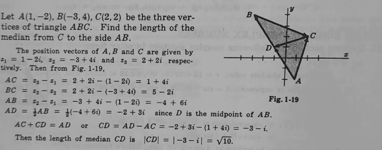

Find the distance CD in the given complex variable question

This is the problem;
Note that i am conversant with the above steps shown in the solution, having said that i realized that we could also borrow from the understanding of gradient and straight lines in finding the distance ##CD##... it follows that the equation of ##BA= -1.5x-0.5##, implying that the co ordinates of ##D(x,y) = (2-3, 4-3) = (-1,1)## and using the distance formula, it follows that;
##CD= √[(3)^2 + (1)^2]##= ##√10## as indicated...
any other approach guys...
[tex]\vec{OD}=\frac{1}{2}(\vec{OA}+\vec{OB})=\frac{1}{2}(1-3,-2+4)=(-1,1)[/tex]
[tex]\vec{DC}=(2-(-1),2-1)=(3,1)[/tex]

True, the whole idea is to have an understanding of the argand diagram and also the Complex number, say ##Z = x + iy##, then it follows that the Modulus of
##Z =|x+ iy|= √[(x^2 +y^2)]##, and also a good understanding of vectors is required.
...but looking at this problem, we could also just use the relationship of ##AD= \frac {1}{2}AB##.
letting the co ordinates of point ##D## be ##(x,y)##, then ##AB= (-3-1)+i(4+2)##
##AB= -4+6i##, therefore ##AD= -2+3i##, also to find the co ordinate of ##AD= (x-1=-2, y+2=3) ##
giving us the co ordinates, ##(-1,1)##
##CD= (-1-2)+ (1-2)i= -3-i##
