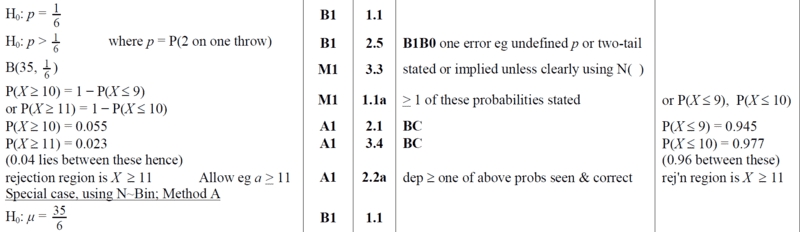

Kindly see attached question and mark scheme guide
##Bin (n,p)##
Consider the question below:
this (below) is the mark scheme for the problem, there were different methods given in the mark scheme but i was interested on this one only...
Now onto my question, How did they calculate ##P(X≥10)##=##1-P(X≤9)##=##0.055##...?

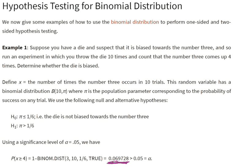

In attempting to understand the question i went ahead and looked at a similar problem (attached below); i.e
and i could see from my analysis that, the highlighted value could have been found using the steps below:
##P(x≥4)=1- [ P(x=0) +P(x=1)+P(x=2)+P(x=3)]##
=## 1- [0.1615+0.3230+0.2907+0.1550]##
=##1-0.9302##
=##0.0698##
ok is this correct? if so going back to our problem, do we use the same approach? or there is a shorter way...
This is the only part that i need clarity. I should be able to come to the deduction on whether to reject or accept null hypothesis.

Yes, this is the way to compute it.
Thanks, implying that a student would have a lot of computation work to do (with calculator) to realize ##P(X≥10)## and ##P(X≥11)##... and then come to some conclusion... Phew!
