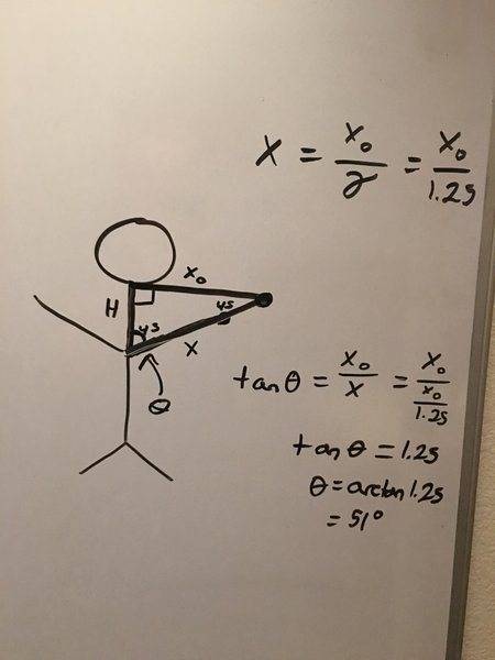

Ok, I think I solved it. I know that x = x0/gamma. Gamma is found by taking 1/(√(1-(0.6c)2/c2) or 1.25 when solved. Then looking at the triangle I want the angle between his arm and shoulder basically. That means I take tan(θ) = opp/adj or x0/(x0/1.25) which is arctan(1.25) = 51.34°. Correct?
That doesn't sound right. I suspect that you are trying to do this in your head without drawing it out and am getting things confused. Make a drawing of the still right triangle with a 45° angle. Change the side (sides?) that should change when it is moving with respect to the Moon (draw the direction of motion). Then do some trig.
This is my picture.
  • Handwritten whiteboard sketch of a stick figure with a right triangle drawn from its chest to a point at the right, labelled x0, H, x and theta, with equations x = x0/gamma = x0/1.25 and tan theta = x0/x = 1.25, theta = arctan 1.25 = 51 degrees.
And which direction is he going in? It looks like your equation is for him going sideways. Also, double check what you are considering opposite and adjacent.

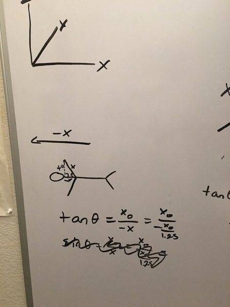

So I changed it up and realized that tan(θ) should be x0/-x, but I still get 51.34° just negative. Here is my picture now.
EDIT: I noticed that h=x-x0 so I ended up getting 71° by taking arctan(x0/x-x0).
  • Handwritten whiteboard work: a coordinate axes sketch with x labelled, a leftward arrow labelled -x, a stick figure diagram with angle theta, and the equation tan θ = x0/-x = x0/-x/1.25 with a further scribbled line below.
Why are both your opposite and adjacent sides of the triangle based on x0? Don't get the sides confused. You should take a second look at the triangles and trig.
Are they supposed to be based on X? I simply solved for h and got x-x0. It simplified very nicely, but i don't know how else to set it up. I know his arm has to be x0 since it's the proper length making the perpendicular leg x and the parallel leg h. Right?
I can't follow what you did. I don't see h in any equation or drawing (do you mean H in the drawing?). I can't figure out why x-x0, which is hypotenuse - oneSide, should appear in any equation. And why is tan(θ) = oneSide/hypotenuse? That is sin(θ). I give up.

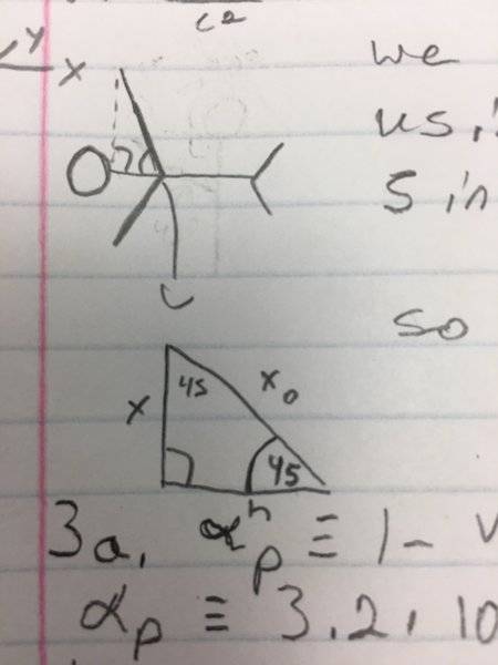

No worries, this is my diagram. "h" is the leg parallel to the -x direction. It's basically the part from his shoulder to his lower head. So the neck I guess.
  • Handwritten sketch of a stick figure diagram with an angle marked at the shoulder, with axis labels x and y, next to a right triangle with legs x and x0 and two 45 degree angles.
Looks right to me. The foreshortening is along the length of his body, so his arms Will appear more horizontal, giving a greater angle with the body.
Except of course you want x0/H for the tangent. But except for this typo, the rest appears correct.
