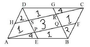

(The image is given in the attempt section,1st image.) In ABCD parallelogram E, F, G, and H are the midpoints of AB, BC, CD, and DA respectively. Area of ABCD is 25 sq.unit. Find the area of PQRS.
area of parallelogram=height*base.
Parallelogram ABCD with points E on AB, G on DC, H on AD and F on BC, and lines DE, HF and GB crossing inside it at P, S, R and Q. Labels A, B, C, D, E, F, G, H, P, Q, R, S.
Through symmetry of parallelogram,I have come to this:
Parallelogram ABCD with points E, F, G, H on its sides and interior points P, Q, R, S, divided into regions labelled 1, 2, 3, 4, 1, 1, 9, 3, 2 by hand-written numbers.
Here 1,2,3,4 denotes the area of the particular regions.Then I am stuck.Please help what to do next or whether there is any other way.
Hi,
the naming is a bit confusing, but you know that
1+2+4 = ...
2x1 + 3 =
4x1 + 2x2 + 2x4 + 3 = ...
manipulate these and see if you can end up with 3 by itself ...

Your solution makes no sense: you have a small triangle with area 9 next to a much larger parallelogram with area 1, next to a smaller triangle with area 2, etc.
Anyway, you need to show your work. Just saying "Through symmetry of parallelogram,I have come to this:" is not an explanation.

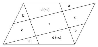

Parallelogram divided into a central parallelogram labeled X and surrounding regions labeled a, b, c and d (=c), with sides and bottom labeled d (=c) and a, b and c on the outer strips.
What would your equations be? Call the area of the parallelogram ##A##.

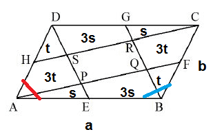

The following figure shows the areas:
242612
The area of the triangle ABF is ab/4 sin (B)=4s+t
The area of triangle AED is ab/4 sin(A) = 4t+s.
As sin(A) = sin(B), the areas are equal.
The area of the parallelogram is absin(A), and it can be written in terms of s and t plus the area of the small parallelogram SPQR.

OK, so here's a summary using ehild's diagram, the fact (which I was missing) that the quadrilaterals are 3 times the area of the triangles, and no trig, just geometry.
ehild said:
Call the area of the given parallelogram ##A##.
From triangle DHC ##t + 4s = \frac A 4##.
And from triangle GCB ##s+ 4t = \frac A 4##. So ##t = s = \frac A {20}##.
The area of the smaller parallelogram is ##A-16t = A -16\frac A {20} = \frac A 5##.
