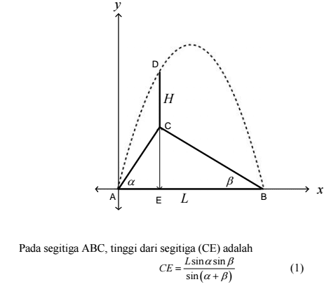

Diagram of triangle ABC with base AB of length L on the x-axis, angles alpha at A and beta at B, and perpendicular height CE from C to E on AB; a dashed parabola-like arc and vertical segment H above C are also drawn.
I don't understand how to get CE.
Trigonometric identities (maybe)
[/B]
First, I start with the cosine rule
CB^2 = AC^2 + AB^2 - 2 AC AB cos α
(CE/sin(β))^2 = (CE/sin(α))^2 + L^2 - 2 (CE/sin(α)) L cos α
which is going to be a quadratic equation and it's hard to obtain what CE is (using this method)
Please help
Try the usual way you derive the cosine rule - except solving for the altitude of the triangle instead of factoring it out.
I think using sine rule to find a side first is a faster way
I get this ##(\frac{1}{(sin^2(\beta))})CE^2+(\frac{2\ L\cos \alpha}{sin \ \alpha})CE-L^2=0##
Then, use the quadratic formula to solve CE??
But if I use quadratic formula, there will be two solutions, but there is only one CE.
And I doubt if the solution obtained will be the same as in the photo I gave
CB/ sin alpha = CA / sin beta
CE = CA sin alpha
CE = CB sin beta
Then whatt??
CE = CA sin alpha
CE = CB sin beta
Then whatt??
angle ACB = 180 - a -b
you can try to use L/sin(180-a-b) = ??
Angle ACB = 180 - (a + b)
sin(180-(a+b)) = sin (a+b)
L/sin(a+b) = CB/ sin (a) = CA / sin (b)
Then??
How to make CE (the altitude) show up o_O?
Then??
You succeeded to express CB (or CA) in terms of L , a and b. Then what is CB sin(b) ?
L/sin(a+b) = CE/sin(a)Sin(b)
CE = L sin(a) sin(b)/ sin(a+b)
Thanks a lot for your help bro

##AE/CE = \cot(\alpha)## and ##BE/CE = \cot(\beta)##. Now add and manipulate.
