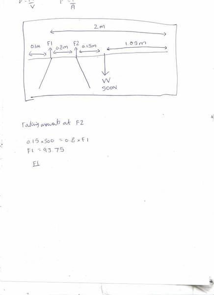

Handwritten diagram of a beam of length 2 m with supports F1 and F2 at 0.1 m and 0.9 m from the left end, a 500 N load W 0.15 m right of F2, and a handwritten working line reading 0.15 x 500 = 0.8 x F1, F1 = 93.75.
in this attachment is a moments problem could someone please help me solve it
the question is
a) using moments find F1
b)using any method find F2
thank you

it shows my attempt but i don't think it is right
any help i would be grateful

i haveto find F1 and i think the best way is to use F2 as the pivot so you automaticaly eliminate F2, then taking clockwise and anticlockwise moments, but that is where i got confused and am not totally sure how to do that part.
Describe the problem a bit more. I don't know how to interpret the diagram yet. Is there some kind of plank? I assume that three forces act on the object: F1, F2, & W? Is the object in equilbrium? Do any other forces act?
Where is this thing attached? Is one end free? Or are both attached?
Is W indicative of the centre of mass, or some mass particle just placed there in addition to the beam(?).
This is too vague and unspecific to make sense of..
its basically like a diving board a long plank and then on the left side there's 2 supports which are 0.8m apart and there is an extra 0.1m on the left side of the first one, W is the weight of the plank and is in the centre of the plank
Okay, picture understood!
So, the diving board is ATTACHED to the point where F1 is, agreed?
In that case, ask yourself:
In which direction should F1 act?
I don't see anything wrong with your solution except the direction of F1. Which way must it point?

i don't understand what is acting clockwise and what is acting anticlockwise
i think F1 is the reaction force but wouldnt' that be the same as the force of F1 acting downwards according to Newton's 3rd law
Don't bother about the clockiness of the moments for now, focus on the direction of FORCES.
Do you agree that F1, the force acting upon the diving board from the support must be downwards in direction?
Barring arithmetical mistakes I haven't bothered to check, yes.
Now, note that the weight will create a clockwise moment about S(upport) 2, whereas F1 will make a counterclockwise one.
Now, knowing that F2 works downwards, what must F2 equal?
Alternatively, compute the moments about Support 1 in order to find F2.
