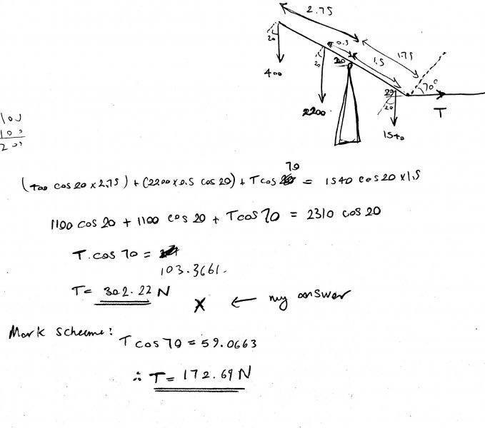

The problem is question 4) iii) B) found in the attachment below.
• sum of c.w moments=sum of anti c.w moments.
• moment of a force about a point= force x perpendicular distance between the line of action of the force and the point.
A full attemp is included as second attachment below. (Note the correct answer is 172.69N not 302.22N I calculated.
Why? How?
Thanks
  • Fig. 4.3: a beam CE tilted at 20 degrees to the horizontal, pivoted at D, with a rope attached to E. A 400 N weight hangs from C, a 1540 N weight hangs from Q, and R is 1.5 m from D.
  • Handwritten physics working: a rod at an incline with forces labelled 400 N, 2200 N and 1500 N, a tension T at 70 degrees, and distances 2.75 m, 1.5 m and 1.75 m; below it a moments equation and the handwritten result T = 302.22 N, with a mark scheme line giving T = 172.69 N.
Hello RU,
by now you should be familiar with the workings of PF and know the guidelines.
Please state the problem by rephrasing it clearly and concisely. List the known/unknown variables.
Helps me and helps you too.
Equations are like ##\Sigma\vec\tau = 0##.
