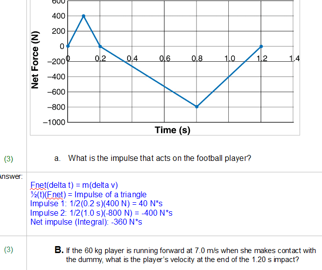

Finding velocity after 1.20 sec impact from force graph

fnet(delta t) = m (delta v)
I need some help on question b ASAP (i'm not sure what the question means when it says find the velocity AT THE END of the 1.20 sec impact)
and i would like for someone to check if I've answered question A correctly
A looks right.And for part B, the problem seems set up where that graph of F vs. t is the forces acting on the player for 1.2s. It gives you an initial velocity, and asks what those forces (so the impulse that you already calculated) make her final velocity.

i believe I've found the integral in part A but i don't know what part b means by "find the velocity at 1.20 seconds"
i've got the following information compiled for part b)
delta t = 1.20 seconds
Fnet = ?
m = 60 kg
vi = 7.0 m/s
vf = ?
my problem is that i don't know what fnet is.
I=Δp
so you know your initial momentum. Now find the final momentum, using the above fact. :biggrin:

impulse. however, i don't know if i did part A right and i don't know if they want me to use all the information in question B... and i do not understand what they mean by AFTER 1.20 seconds
Look at the graph again .
You have an initial momentum - think about how that impulse ( change in momentum) will change the player's speed. (you're looking for pf)
Your part A was right.
And it just means that at t = 0 the velocity is 7, what is the velocity at t = 1.2?
i think i got it
-360 n*s = 60(vf-7)
-6=vf-7
vf=1 m/s
