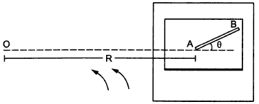

What would be the forces acting on the particle in groove for problem given below when the observer is a ground observer i.e. in an inertial frame of reference? So, observer is not in rotating cabin which would be a non-inertial reference frame of reference.
I know that at any instant of time, the particle will have a tangential and a radial centripetal acceleration but cannot figure out the free body diagram of the particle. As a result of tangential + radial acceleration, the particle will traverse a complex curved path relative to ground observer.
F=m(ww)r ( m times w squared times r where w is angular velocity of rotating object)
A table with smooth horizontal surface is fixed in a cabin that rotates with a uniform angular velocity ω in a circular path of radius R. A smooth horizontal groove AB of length L(<<R) is made on the surface of the table. The groove makes an angle θ with the radius OA of the circle in which the cabin rotates. A small particle is kept at the point A in the groove and is released to move along AB. Find the time taken by the particle to reach the point B.
Diagram of a circular path of radius R centred at O, with a straight groove AB of length L drawn at angle θ to the radius OA; the groove and the radius OA are labelled, and curved arrows show the circular motion.
What happens to the particle if ##\theta = 0##?
What happens if ##\theta = \frac{\pi}{2}##?

The groove is always horizontal on the table since the surface of table is always horizontal. (θ is not meaning that the grove is inclined above the horizontal but its just the angle made by the groove with the radius)
Okay, I misread the diagram. I assumed ##\theta## was an angle with the vertical. Apologies.
As you say, it should be simple to analyse this in the rotating frame with the fictitious centrifugal force.
To analyse it in the ground frame, you will need the equation for acceleration in polar coordinates. In which case it may be better to rename ##\theta## to ##\beta## to avoid confusion with the conventional polar angle ##\theta##.

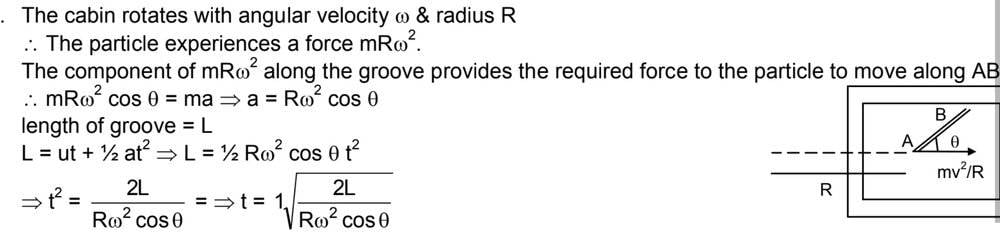

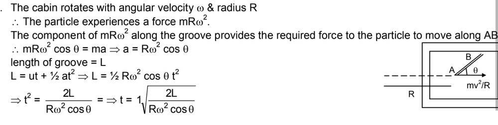

A solution to this problem that I saw from someone else is as below. The person assumed no forces were acting on the particle other than centrifugal force (mg would cancel with R). But it makes little sense to me. His answer is matching with the answer given for this problem.
Handwritten-style solution text on the left deriving time t for a particle in a rotating cabin, ending with t = sqrt(2L / (R omega^2 cos theta)); on the right, a diagram of a rotating cabin with a groove from A to B at angle theta and a radius R arrow labeled mv^2/R.

That's the easy way - using the rotating reference frame. I thought you wanted to do it the hard way using the ground frame?
That solution is simply what happens to the particle if you give it a constant force in the direction of the arrow. The force is canceled out in the direction normal to the groove and moves smoothly along the groove.
Note that it's the same problem as an object sliding down a ramp inclined at ##\theta## to the vertical, with a gravitational force ##g = mR \omega^2##.

I see a paradox in the simple solution. It's implying that besides the normal reaction and weight of particle mg there are no external forces. If we assume this as true then for an observer on Earth there are no forces on the particle that can supply the centripetal acceleration. Do you get the paradox arising due to the simple solution?

I explained that in post #8. The "paradox" is due to a tangential force producing radial motion.
To see this imagine a particle at rest at coordinates ##(1,0)## (i.e. on the x-axis). Give the particle a brief impulse in the positive y-direction. The particle moves along the straight line ##(1, y)##.
But, by your logic, the initial impulse was "tangential" to the circle centred at the origin, so the motion should remain "tangential": i.e. the particle should move in a circle!
It doesn't because as it moves in a straight line the local polar basis vectors change and the straight line motion is no longer in the ##\hat \theta## direction but has a ##\hat r## component as well. And it's clear that the tangential impulse produced tangential and radial motion.
