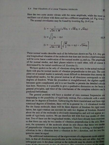

This question is regarding equation 6.59 in Classical Mechanics Goldstein 3rd edition. I don't understand how he reaches that step. He says he does by inverting 6.41. Is he taking the transpose matrix composed of the eigen vectors by meaning inversion ?

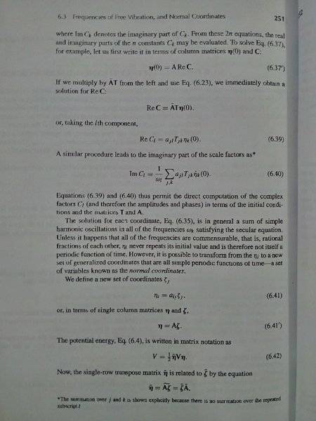

  • Scanned textbook page 251, section 6.3 on frequencies of free vibration and normal coordinates, with equations 6.37 to 6.42 including Re C, Im C_i and the matrix relation eta = A xi.

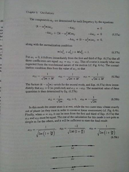

  • Textbook page of equations 6.57a to 6.58c on normal mode coefficients a_ij for a linear triatomic molecule, with a diagram of three atoms in three displacement patterns labelled (a), (b) and (c).
  • Scanned printed textbook page titled 6.4 Free Vibrations of a Linear Triatomic Molecule, showing three normal coordinate equations zeta1, zeta2 and zeta3 in terms of eta1, eta2, eta3 and masses m and M, labelled Eq. (6.41).

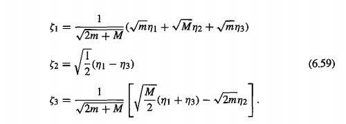

Okay Thanks for the guidance. So The results he gets are in the picture names 'Physics forums' and he says he gets them by inverting this equation show in the picture 'Physics forum 1'. I inverted the aij matrix to aji since it is an orthogonal matrix. But I am not getting the same answers. Can anyone help ?
  • Three equations labelled (6.59) defining normal coordinates zeta1, zeta2 and zeta3 as linear combinations of eta1, eta2 and eta3 with coefficients involving square roots of m and M.

  • Equation: eta_i = a_ij zeta_j, with subscript i on eta and a_ij, and subscript j on zeta, written in a handwritten-style printed equation.

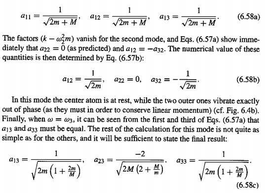

This is the original matrix. So I just transpose it and the rows become columns and columns become rows.
  • Equations 6.58a, 6.58b and 6.58c giving matrix elements a11 through a33 for a linear triatomic molecule, with a12 = -a32 and a22 = 0 noted in the text.
