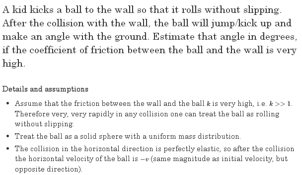

Printed problem statement: a kid kicks a ball to a wall so it rolls without slipping, then jumps up at an angle; estimate that angle given very high friction, with details and assumptions bullets.
I have dealt with the case when the wall is frictionless and the rolling ball collide with it but I am not sure how to proceed here. When the ball comes in contact with the wall, the friction due to wall acts in the vertically upward direction for a very short time. Hence,
$$\int fR\,dt=I(\omega_f-\omega_i)$$
and
$$\int f\,dt=mv_i$$
where ##f## is the friction due to wall and ##R## is the radius of ball. How do I relate ##v_i##, ##\omega_f## and ##\omega_i##? (where ##v_i## is the velocity acquired by ball in vertically upward direction.) :confused:
Also, which angle does the problem talks about? Is it the angle made by line joining the intersection of wall and floor with centre of ball and the ground? :confused:
Any help is appreciated. Thanks!

Problem statement text: A kid kicks a ball to the wall so that it rolls without slipping, then jumps up and makes an angle with the ground; estimate that angle if the friction coefficient is very high. Followed by bulleted details and assumptions.

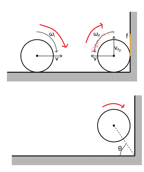

I knew I was messing up with the signs, let me clear everything. Please have a look at the attachment. I consider anticlockwise sense to be positive and I follow your notation for the final vertical velocity.
$$\int fR\,dt=I(\omega_f+\omega_i)\,\,\,\, (*)$$
(plus sign because ##\omega_i## is clockwise)
$$\int f\,dt=mv_{fy}\,\,\,\, (**)$$
I used different variable names. I used ##v_{iy}## = 0 as the initial velocity in the y-direction and ##v_{fy}## as the final in the y-direction. But that's neither here nor there. You can use whichever variable names you want.
The key to the relationship is to note that the ball does not slip against the wall when it touches the wall.
From the non-slipping condition, I have
$$\omega_i=\frac{v}{R}$$
$$\omega_f=\frac{v_{fy}}{R}$$
From the above relations, (*) and (**), I get:
$$mv_{fy}R=I\left(\frac{v_{fy}}{R}+\frac{v}{R}\right)$$
Also, ##I=(2/5)mR^2##. Plugging this and solving for ##v_{fy}##, I get
$$v_{fy}=\frac{2v}{3}$$
The maximum height attained by the ball is given by:
$$h=\frac{v_{fy}^2}{2g}=\frac{4v^2}{18g}$$
The position of the ball from the wall when this maximum height is attained is:
$$x=\frac{4v^2}{3g}$$
I interpret that as an acute angle with the floor. For example, if the ball simply rolls back on the floor (which it won't), the angle is 0o. If it goes straight up against the wall (which it won't) the angle is 90o.
Does the question asks angle ##\theta## shown in attachment? If so, then
$$\tan\theta=\frac{h}{x}=\frac{1}{6}$$

I do not think this and the picture are correct. In the picture, you have the ball rolling backward after the collision. How do you justify that? If we assume that it is still in contact with the wall at this stage, it must also be rolling downward. This cannot be true.
I think you should assume that the direction of rotation is preserved (clockwise), but the angular speed is changed.
But what you do have to take into account is the direction of torque (counter-clockwise).

I've redrawn parts of the diagram with my own take on it.
I'm pretty sure that there is no mechanism that could bring the ball to rotate in the opposite direction in this situation. The ball is rotating clockwise before it hits the wall, and it is still rotating clockwise after it leaves the wall -- it's not rotating as fast! The rotation has slowed down a bit -- but it is still rotating clockwise.
Friction against the wall is the only force acting on the ball. So unless the wall itself is moving (like a vertical conveyer-belt), there's nothing that could cause the ball to change its direction of rotation such that the ball also maintains an upward, linear velocity.
Remember, the ball is glued against the wall for that short time of impact. If the ball is moving up a little (which it is), it must maintain its clockwise rotation. Otherwise it would imply slipping, or some other force involved.
Here is my take of the diagram.
Two-panel diagram of a ball striking a vertical wall: top panel shows the ball rolling right with angular velocity ωi and speed v, then after impact with ωf, vfy and v labelled, and friction f acting up on the wall; bottom panel shows the ball against the wall at an angle θ with a clockwise rotation arrow.
I've tried to indicate the the angular rotation has slowed down a little by the smaller arrow after it hits the wall. But it is still moving clockwise.
Which is related to another point that I mentioned in my last post about the torque.
The ball's rotation is clockwise, but the what direction is the torque? I believe the torque would be in the anticlockwise direction. That would make ωf smaller than ωi, not larger.

Changing the plus sign to a minus sign wasn't what I was referring to in my last post. You are looking for the change in angular momentum (which is what R times the impulse is). So there still needs to be a subtraction involving ωf and ωi.
In your last post you had,
$$ \int f R \ dt = I(\omega_f - \omega_i) $$
But from what I can tell from that equation (directly above), the torque would cause the ball to speed up its rotation.
I think you need to either switch your ωf and ωi around, or put a negative sign on the ∫fRdt.
Something to account for the torque being in the opposite direction of the rotation. The final angular velocity will end up being smaller than the initial angular velocity.
That one looks fine though. The force is in the up direction and the final momentum is in the up direction. All looks good to me there.
If I showed the ball at a height above the ground, would it be correct then?
Rolling downward? :confused:
Yes, the direction should stay preserved as it would slip if the direction was counter-clockwise.
I make the equations again:
$$\int fR\,dt=I(-\omega_f+\omega_i)$$
$$\int f\,dt=mv_{fy}$$
Hence, ##v_{fy}=(2/7)v##.
Is it correct now?

That's what I got. :approve:
Now just use your inverse tangent method to find the angle and we're all set! :smile:

voko said:
Hmm. Why did they want to insist on non-conversation of energy?
[STRIKE]Now that you mention it, after doing some calculations, not only is energy not conversed, but something seems to have violated the second law of thermodynamics. :cry:
Yes, something is definitely wrong with some assumptions with this problem, one way or the other. :confused:[/STRIKE]
[Edit: nevermind]
voko said:
Second law of thermodynamics? In what way?
Sorry. Miscalculation when I was summing up all the energies. I thought for a moment that the ball ended up with more energy than it started with.
One second comparison, it doesn't. So the answer doesn't violate any fundamental physical laws at least. Whew!
