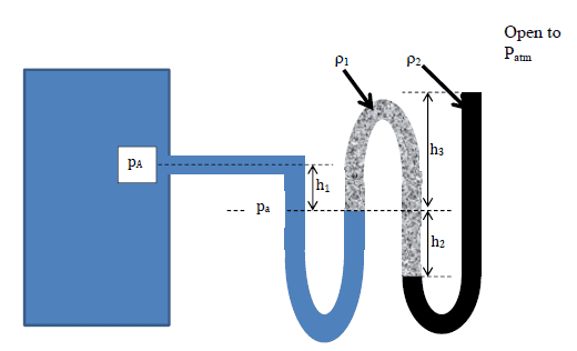

The manometer shown below measures the pressure of the water in the tank. Using variables for
the densities (no values given), find the gage pressure at point A. Use the symbols ρw, ρ1, and ρ2
for the water and the two manometer fluids.
A picture is attached
P1-P2=(g/gc)(densitya(h1-h4)+densityb(h3-h2))
PA=Patm+ρ2(g/gc)(h3+h2)+ρ1(g/gc)(h2)-ρw(g/gc)(h1)
Im not sure if this is correct or not. Because 1 & 2 have increased pressure going down the tube they were added to Patm and the water had less pressure so it was subtracted. I am not sure if this is right so any input would be great.
here is the manometer picture
  • Diagram of a multi-fluid manometer: a tank labelled pA connects by a pipe to a U-tube, which connects to a second inverted U-tube with fluid densities labelled ρ1 and ρ2, the right leg open to Patm, with heights h1, h2 and h3 marked and a reference line labelled pa.
