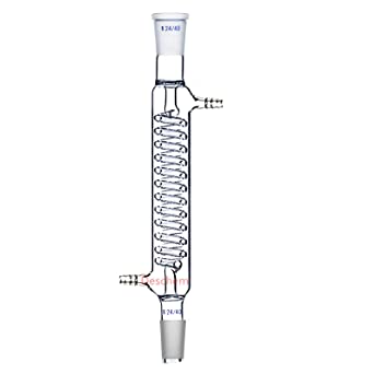

Sounds like a condenser column.
That's along the lines I was thinking it condensing the refrigerant, could it be strong enough to be a structural part of a building ? solar thermal properties if cold and if hot cooling? Thank you all for your time

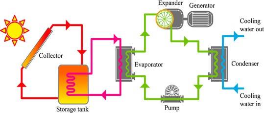

So, again; you're describing a condenser, but in order for this to be the source for a heat pump it needs to be an evaporator.
I would not expect this to be a viable structural material for a building. It's rare to use glass for structural applications because it is so brittle. But it can be strong.
It would actually be both evaporator and condenser depending on the season.
Could be, though thus far he's only describing winter/heating. For summer/cooling I'm not sure where the heat would reject to.
