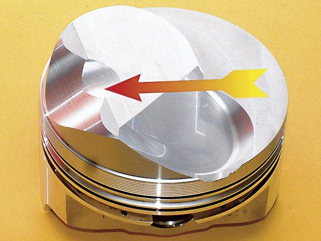

I would say flame propagation. With a single ignition point, the flame must travel to the end of the combustion chamber. With high compression, the combustion chamber may be too small to permit proper flame travel (which is mostly done with the swirl of the mixture). Think of high-compression race engines with a grinded path into their dome pistons to solve that problem:
Having an instantaneous ignition within the entire combustion chamber seems to be a nice advantage.
