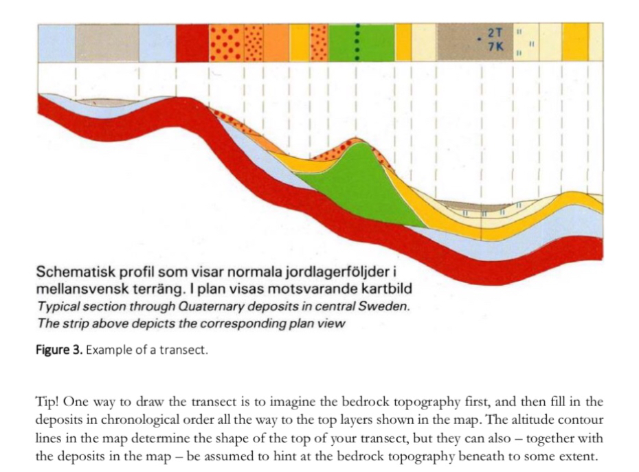

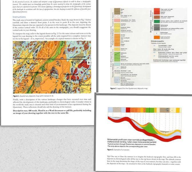

Please I need help with this one!
Drawing a Quaternary deposits’ profile
The purpose with this practical is to understand how a map showing Quaternary accumulations is built up and how it may be interpreted. The information is shown in 2- dimension but has to be interpreted in 3-dimensions, i.e. stratigraphy. The task is to draw a section based on information along the profile from A to B in the lowermost figure. As a guide there is a general section shown and a legend. Draw the different Quaternary deposits in the right order and the right extension along the profile. You have to exaggerate the elevation scale in order to fit in all accumulations. A good starting point is to draw the bedrock topography first and then fill in the various accumulations in chronological order. Note that altitude-lines for the surface topography are indicated in the map. Also write maximum 600 words describing the various landscape changes over time that caused these accumulations. The profile is located in Uppland, eastern central Sweden.
Note that the transect in figure 3 is an example of a typical transect, and NOT the correct answer!
I have attempted to draw a straight line from point A to point B but that is wrong :/ How am I supposed to draw this?

I would start by using the altitude information to draw a profile of the surface along the line AB.
If you can figure out which colour marks the most recent deposit, you can then add those sections as lenses hanging under the profile line. Then go for the next most recent deposit. Where two instances of that flank only more recent deposits, continue the stratum under the more recent ones to join up the instances.
What I cannot see how to do is to decide where you should not connect up instances like that. E.g. in the example it shows the big green blob sitting directly on the red band; the light blue band, with an age between those of the green and red, only continues a short way under the green. There is no way to tell that from the surface data.
Thank you so much! But I don’t know how to draw it at all, how do I know what shape it should be? And how long?
The first part, the surface profile, is like drawing a graph. Going from A to B is along the x axis, while the heights given by the contour lines in the first figure give you the y axis.
But how do I know the lengths? And which direction?
The figures as posted are not very clear, so I cannot be sure whether there are any contour heights or spot heights on the map. But you do not need any. Just assume the contour lines are at equal height intervals. Where you see a closed loop contour you can assume the uphill side is inside the loop - unless there is a lake inside it.
Mark equal distances up the y-axis to correspond to the contour lines. See where they cross the AB line and mark the corresponding (x,y) points on the graph.
If you still do not understand you will need to post much clearer images so that I can be more specific.

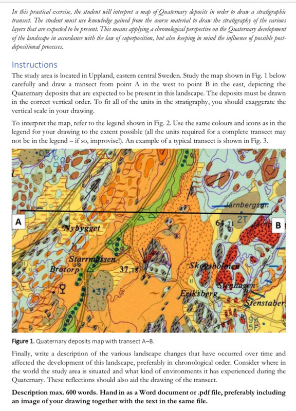

Here are the pictures, please help me! :(
Maybe that is easier to see

Yes, that's better.
I'll try to talk you through an example.
Find the 't' of Nybygget. Go north to the line AB. This is in an orange area. Just to the east and west a loop of contour line crosses AB. The loop is mostly to the northeast. A bit further east a smaller loop also straddles AB.
You can interpret each of these contour lines as surrounding a hill. Since there are no other contour lines separating them, the two contours are at the same height, and the region between them is a dip.
Pick a y value to represent the height of this contour line and mark the four crossing points on your chart. The x coordinates are the distances from A. Sketch in the two hills and the dip. These will only be small since they do not reach the next contour heights.

I get
A at 50+
a plain between 40 and 45
with two hills above 45
a valley that dips below 30
a tiny hill that just goes above 35
a long slope up to 35 at B.
That seem right?

It's hard to figure out whether the first section from A is tending uphill or downhill. Looks to me like uphill.
I cheated and found
https://www.google.com/maps/dir/Eri...a43aa5e8f5c!2m2!1d17.9194346!2d59.6254993!3e2
Nybygget is shown at about 35m.
Note that "up" on the supplied map is roughly SW.

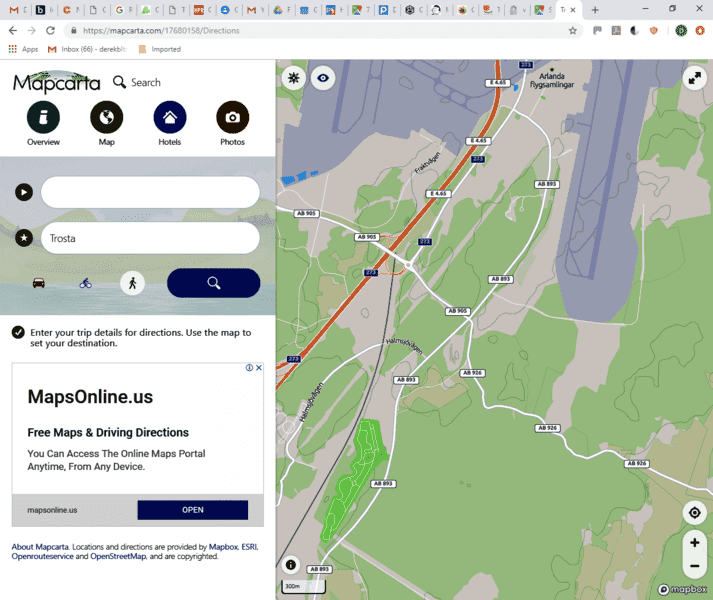

Forget all that... despite the myriad of Nybyggets in Uppland I happened to pick the right one, but the Eriksberg and Stenhagen were spurious.
Finally found it south of Stockholm Arlanda airport.

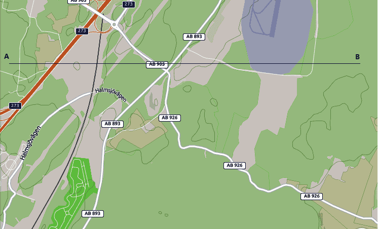

Lotta, if you bring this up in Mapcarta (https://mapcarta.com/17680158/Directions; you may need to go left and down a bit) and zoom in more than in the above image it will give you 10m contour lines.

I can’t see Any? I am sorry I’m really bad at this! Its a onlinevourse I’m taking that I just need to pass to keep my spot at another program :(
Can't see any what? Contour lines?
Starting with the screen that comes up at the link I posted, make the map area full screen, then scroll left and down until you see the Arlanda golf course at bottom left and the southernmost bit of the grey airport area at top right. You will see the E4 as a vertical line.
Zoom in once or twice and you should see contour loops labelled as 50m, with some fainter contour lines. The fainter ones will be at 10m intervals, so those nearest the 50m lines will be either 40m or 60m.

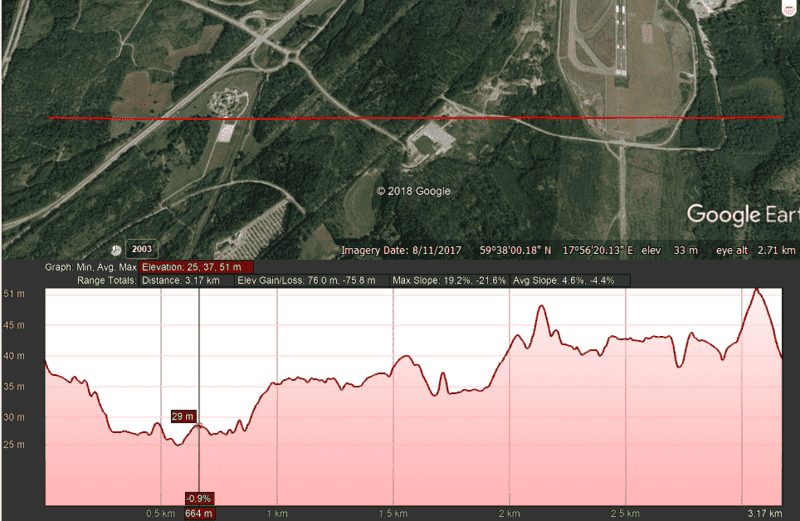

I located it in Google Earth Pro and obtained this profile. The end points might not be exactly right, but I think I have it pretty much as an EW line of just over 3km. I suspect it is supposed to be exactly 3km.
