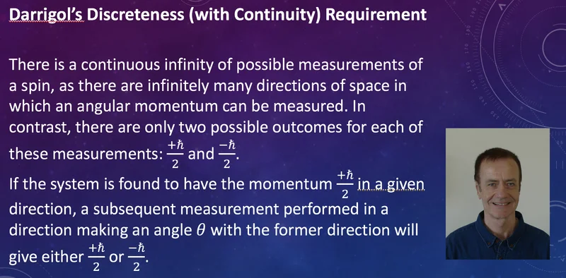

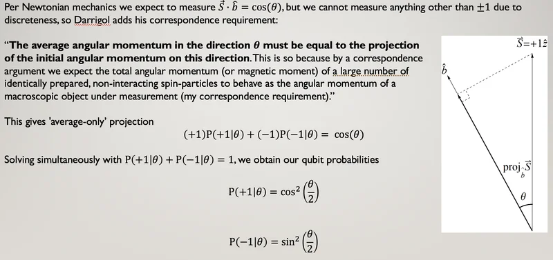

Turns out the probabilistic (indeterministic) nature of quantum mechanics (QM) follows from the discrete outcomes. I can't explain all the details in a short post here, but you can see more starting at about the 6-min mark in my video:
Just ignore the context. I'm going to refer to work by Darrigol from this paper:
title = {``Shut up and contemplate!'': Lucien Hardy's reasonable axioms
for quantum theory},
author = {Darrigol, O.},
journal = {Studies in History and Philosophy of Modern Physics},
volume = {52},
pages = {328-342},
year = {2015}

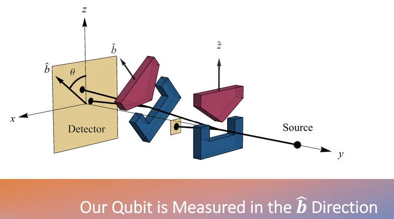

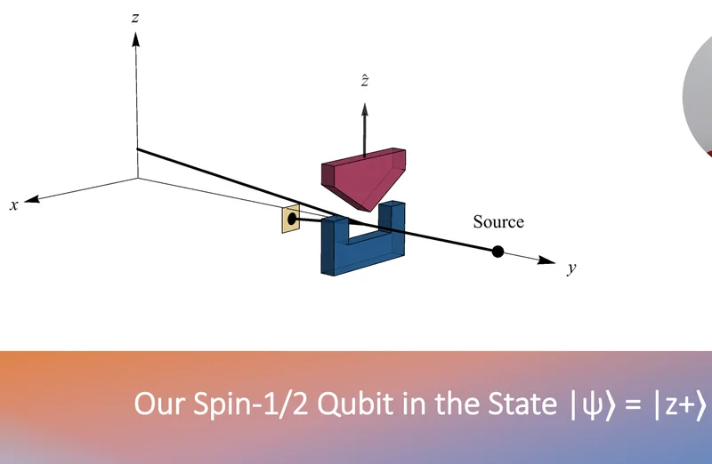

I'm going to outline how he derives the spin-1/2 qubit probabilities using slides from my video. Here is your spin-1/2 qubit:
Now make this measurement:
Here is how Darrigol explains the outcome:
And here is how he derives the spin-1/2 qubit probabilities:
So, you see that if we would just obtain that cos(theta) outcome in the first place, we wouldn't need 'average-only' projection whence a probabilistic outcome (qubit superposition). It's the discrete outcomes that force us into implementing the "correspondence requirement" whence indeterminism. And, the discreteness requirement is itself a real mystery, as Darrigol admits:
From a physical point of view, [discreteness] is a non-trivial assumption. … In the present state of this approach, we should probably content ourselves with the insight that quantum discontinuity, if it is admitted as a fundamental feature of the microworld and if it is complemented with natural axioms concerning the relation between micro- and macro-world, necessarily leads to quantum mechanics as we know it.
In other words, if we assume discreteness and correspondence, then QM follows, but we don't have any a priori justification for the discreteness assumption.
