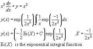

Here is an image of the first order linear differential equation and my attempt to solve it. It ends in an integral that can not be solved.
http://img831.imageshack.us/img831/9937/math1.gif
And here is an image of the first order non-linear differential equation and my attempt to solve it. This one leads to a non-separable differential equation after a substitution.
http://img215.imageshack.us/img215/4893/math2.gif
Any advise?
You have:
[tex](1-y)dx+xydy=0[/tex]
You can find the [itex]1/M(M_y-N_x)[/itex] integrating factor for that.

The integrating factor isn't working. I was under the impression you can only use the integrating factor only when the two partials differ by a constant only, which they do not. :\

y(x) cannot be expressed in terms of a finite number of elementary functions. The closed form requires a special function :
