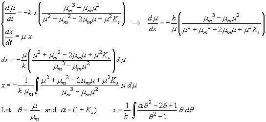

[tex]\frac{d\mu }{dt}=-\left( kx\right) \left( \frac{\mu _{m}^{3}-\mu ^{2}\mu<br /> _{m}}{\mu ^{2}+\mu _{m}^{2}-2\mu \mu _{m}+\mu ^{2}K_{s}}\right)[/tex]
[tex] \frac{dx}{dt}=\mu x[/tex]
Any method for me to solve the pair of nonlinear equations or numerical graph of the differential equation.
*[tex]\mu_{m}[/tex] and [tex]K_{s}[/tex] are constants.
I suggest first to eliminate t in order to obtain the relationship between x and mu.
So that the function x(mu) appears on the form of a solvable integral (in attachment)
Then bringing back x(mu) into the original ODE system would lead to a differential equation where the remaining unknown function is mu(t).
