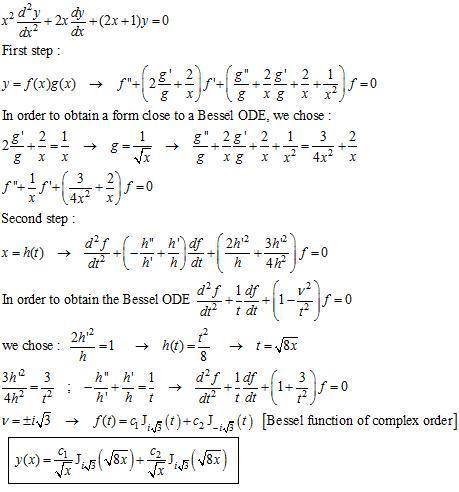

Hi !
Jackmell is right : The ODE if of the Bessel kind, but in fact not in a standard Bessel form.
So, we look if there are solutions on a more general form :
y(x) = g(x)*f( h(x) )
where g might be an elementary function, f a Bessel function and h an elementary function.
If no, we will have to search for something else.
If yes, OK, the problem is solved. Fortunately, that is the case
(In attachment, i will not detail in order to avoid receiving a warning and have my post deleted as it happened recently in a similar case)

OK, there is a typo in the last formula : the sign - is missing in the order of the second Bessel. The formuia is corrected in next attachment.
Don't be afraid by the notation "imaginary order". In the standard Bessel ODEs, there is a parameter which, centuries ago, has been noted n². So, if this parameter is negative, now we say "imaginary order". But real solutions exist as well (attachment).
If you use softwares such as Matematica, WolframAlpha, or others, you can compute Bessel functions of real or imaginary orders exactly on the same manner.
