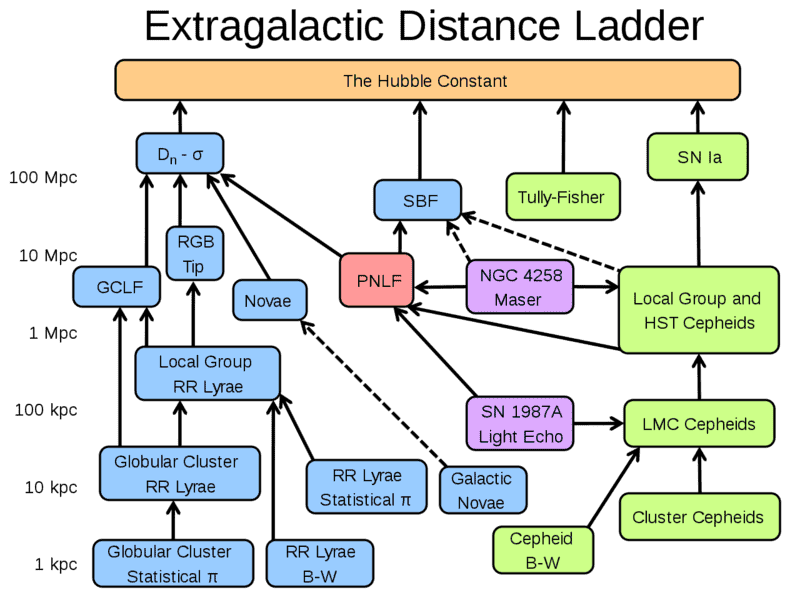

Today we also have much better overlap between multiple elements of the distance ladder. We know how far nearby Cepheids are (like Polaris or Delta Cephei) and sure enough, the same relationship. Same argument for ones farther away.

Not just "some" overlap. The Cosmic Distance Ladder is a big part of the how we get confident about distances. That's the term you're looking for.
