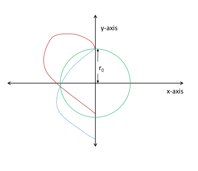

Here's what I've thought.
See attachment 2. I think that the emitted electrons will follow trajectories which would intersect at a common point. The differently coloured trajectories shows different trajectories for emitted electrons.
I am having trouble making equations now. I just don't know where to start from.
The centrifugal force is balanced by the attractive force due to the electric field of cylinder. This is for the electron emitted exactly to the left.
[tex]\frac{mv_0^2}{r_0}=eE[/tex]
where E is the electric field due to long cylinder.
[tex]v_0^2=\frac{eEr_0}{m}[/tex]
This speed is same for all the emitted electrons as per the question.
Any help is appreciated. Thanks!

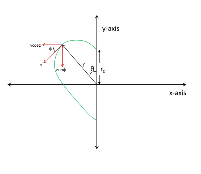

I was expecting that I would have to use Polar coordinates here but I am not much familiar with them. See the attachment .
The forces acting on the electron are centrifugal force and force due to electric field of cylinder.
I can't calculate the centrifugal force as I don't know the radius of curvature. Is it simply r? :(
The velocity vector is tangent to the trajectory. How do I calculate ##\phi## in terms of ##\theta##?
I am sure there are formulas for motion in polar coordinates somewhere.
How do I calculate ϕ in terms of θ?

Are these equations fine?
[tex]m\frac{dv_x}{dt}=eE\sin\theta[/tex]
[tex]m\frac{dv_y}{dt}=eE\cos\theta[/tex]
where ##v_x=v\cos\phi## and ##v_y=v\sin\phi##

Your definition of angles looks confusing. I would not introduce ϕ at all, I don't see how it helps. v_x, v_y are fine, you can convert them to r', θ' afterwards.
