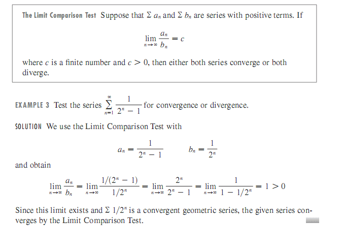

Anyways, I'm trying to figure out series and sequences. I'm using Stewarts' Single Variable Calculus: Early Transcendentals, 6th. ed.
For instance, under Section 11.4, the Comparison Tests, I don't understand how one arrives at bn.
Example:
[tex]\Sigma[/tex][tex]^{\infty}_{n=1}[/tex][tex]\frac{1}{2^{n}-1}[/tex]
The book then proceeds to state:
an = [tex]\frac{1}{2^{n}-1}[/tex], which I understand because it's written as [tex]\Sigma[/tex]an.
However, the book then proceeds to state that:
bn = [tex]\frac{1}{2^{n}}[/tex], which I have no idea how they got there. Do I just remove all constants from an? Or do I remove all variables that are not attached by an "n"?

I just skimmed your first post... I think this is relevant though:
B sub n is just some other series that was (almost) arbitrarily picked because it converges.
You can use the limit comparison test. I don't know a good mathematical way to explain this, but when I learned that test, my instructor called bn the "simpler version" of an. As it was stated earlier, we know that [tex]\sum^{\infty}_{n=0}[/tex][tex]\frac{1}{2^{n}}[/tex] converges. So, the limit comparison test says that if lim[tex]_{n\rightarrow\infty}[/tex][tex]\frac{a_{n}}{b_{n}}[/tex]=c, and c>0, then both an and bn converge or both diverge, if bn converges, so does an and the same goes for divergence.
[tex]\frac{1}{2^n-1}> \frac{1}{2^n}[/tex]
because the numerator on the left is smaller than the numerator on the right. However, that really doesn't help because you want to show this converges so you need "<" not ">" to a convergent series.
You might say [tex]\frac{1}{2^n-1}< \frac{2}{2^n}[/tex]
and then argue that since [tex]2\sum_{n=0}^\infty \frac{1}{2^n}[/tex] converges, so does [tex]\sum_{n=0}^\infty \frac{1}{2^n-1}[/tex]
