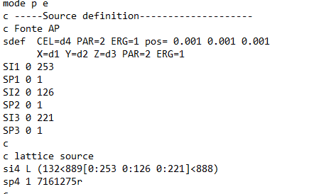

Configure sdef card for lattice cell
I would like some help to configure the SDEF card for a lattice cell.
I am configuring it but I am getting the error "fatal error. Cell 889 in SDEF CEL path not at lev=0"
I have tried several configurations but I am not having any success, please help me. I want to set cell 132 as my source

sdef CEL=d1 PAR=2 ERG=1 pos=0 0 0
si1 L (132<222<889)
sp1 1

Do I need to put the pos inside the cell of interest? Because the cell I want to make the source is well above the position 0 0 0, but mcnp understands by the exclusion method that I only want the voxels of cell 132?
I'm very confused with this configuration, I set the pos to 0.001 0.001 0.001 and now I get the error "input 1 in SI 4 for independent variable cel at last sampled position 0.00000E+00 0.00000E+00 0.00000E+00 seems incorrect."
I changed the multiples 222 to 222 7161275r and that shortened the input a lot, thanks. But the source error still remains. Am I making a mistake in SI? in sp? Do I have to set xyz to the size of the lattice?
Text listing of an MCNP input deck: mode p e, a source definition card sdef with CEL=d4 PAR=2 ERG=1 pos=0.001 0.001 0.001, distributions SI1 0 253, SP1 0 1, SI2 0 126, SP2 0 1, SI3 0 221, SP3 0 1, and a lattice source card si4 L (132<889[0:253 0:126 0:221]<888) with sp4 1 7161275r.
This is so far from what I know it could be genius or madness or nonsense and I cannot tell.
Why a 'lattice source', why not a volume source and why is CEL=888 not good enough? There are histogram distributions of cell numbers fed into position coordinates. There is a hierarchical cell specification normally used for tallies in an SI card. Has any of this been shown to function correctly?
I guessed from the first fragment you are implementing a voxel model but I don't see how this fits. Why would every voxel need it's own source? I think I need some background about what this is and why this approach.
