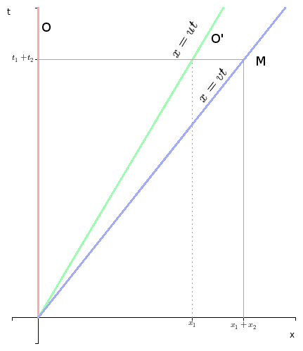

So I've tried to draw a displacement-time diagram based on this. My software for this uses the relativistic convention of time going up the page and space across it, but this is otherwise exactly the kind of diagram one learns at school. I've drawn the trajectory of O in red, O' in green, and M in blue, and marked the equations of motion.
I've also marked the time ##t_1+t_2## from which we can deduce ##x_1##, the distance traveled by O' in this time, and ##x_1+x_2##, the distance traveled by M in this time. Note, though, that although the distance traveled by M between time 0 and ##t_1+t_2## (measured by the horizontal grey line) is divided into two sections where the line crosses the trajectory of O', there is no similar division of the vertical line - it does not cross the green line at all. That is, there is no natural division of ##t_1+t_2## into ##t_1## and ##t_2##. It is, of course, possible to construct ##t_1## by noting where the dotted grey line crosses M's trajectory and dropping a perpendicular. But this is not anything that can be measured in any way - there are no markers that will let you do it in practice. Of course you can take the elapsed time ##t_1+t_2## and multiply by ##x_1/(x_1+x_2)##, which is what you are doing, but what's the point?

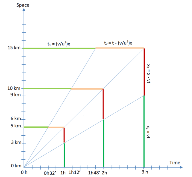

@Ibix (and PeroK), I was going to send a drawing and clarify the problem with that time t1<t. But I will have to give up because the thread closes. I don't understand this rush to close the threads - does it cost the organizers money if we talk on the forum? I will definitely give up this forum with problems. If you want to talk more, we can do it by e-mail [personal e-mail deleted by the Mentors]. Good.

I was hoping to see a response to my diagram, which separates times and distances where ilasus' diagram in the other thread conflates them. I thought that might move the conversation in a helpful direction. Obviously not if, as seems to be the case from #14, OP is gone.

Sometimes we consider mistake what we cannot understand. The “fifth error” is present in the attached graph, in which the formulas (1), (2), (3) are visualized, in which O' and M are mobile moving with constant speeds v=3km/h and respectively u=5km/h, on a straight road on which a landmark O is fixed in the initial place x0=0km and respectively in the initial moment t0=0h - vertically the distances x1 and x2 are seen at the moments t=1h, t=2h, t=3h, and horizontally you can see the time intervals t1 and t2 at distances x=5km, x=10km, x=15km - colored in green and red respectively.
The line at approximately 45° represents M. The line below it represents O'. What's the line above it?
Edit: note that ilasus' diagram is flipped with respect to mine, with the time and displacement axes switched.
In the diagram presented by me also takes into account the time travel of M (with speed 1/u=(1/5)h/km) and O' (with speed v/u2=(3/25)h/km) in relation to O considered at rest relatively in time.
In other words, you've added a line that connects some points you want to be connected but doesn't represent anything that's actually there in reality. That is exactly the criticism I was making in #14 #12.
