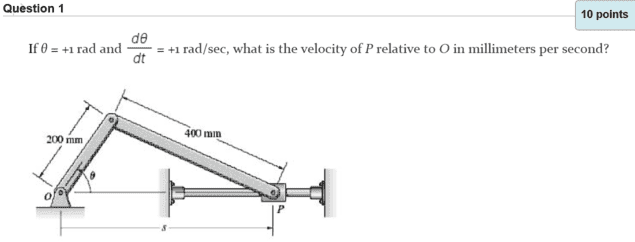

I uploaded the picture to this problem, but it asks what the relative velocity of point p is to point o when theta is equal to one and the derivative of theta in respect to time is also positive 1. the picture explains everything.
Tangential velocity is equal to omega (angular velocity) times the radius. the radius would be the 200 mm arm in this case.
Honestly, my solution seems too simple, but the logic seems right to me. I basically just used the equation
Vt=ω*r
the Vt=200*1=200
then just used the cosΘ=Vxt/Vt
and solved for Vxt with Θ=1 rad and Vt = 200
the answer I got was 108.0598mm/s
I went off the idea that the Vtx value would always have to be equal to the velocity of PI may have gone horribly wrong somewhere but I'm not really sure if I have. Thanks for the help, you guys and girls rock!

I don't think your assumption is correct.
The motion of P would only be the same if the x distance between the two point were fixed, which it is not, it changes as the connection point moves up or down.

Yeah, I am in agreement with andrevdh that your assumption is not correct. Here's why I think that. Start by disconnecting the two rods at the connection point (I am going to call that point T for Top) and taking the shorter rod completely out of the picture. Then if you pull vertically upward at point T on the remaining rod (the right-hand rod), that will produce movement of point P to the left. Note that leftward velocity of point P can be produced by vertical velocity (only) of point T. For that reason, your assumption is incorrect that the velocity of point P is equal to the x component of the velocity of point T. The only times when the velocity of P is equal to the horizontal velocity of point T is when the left rod is vertical (θ = 90°) - the point when the vertical component of the velocity of point T is equal to 0, or when the left rod is horizontal (θ = 0°) - the point when the horizontal component of the velocity of point T is equal to 0. Edit: I reversed θ = 0° and θ = 90° above; I had them backwards.
The way I see it, the velocity of point P in the x direction is the sum of two components:
1) the velocity of point P due to the x component of the velocity of point T (these two are equal)
2) the velocity of point P due to the y component of the velocity of point T (the relative size being dependent on the angle θ)
So I agree that your answer of 108.0598 mm/s is the x component of the velocity of point T. Now you have to find the velocity of point P produced by the vertical component of the velocity of point T.
Please post when you come up with a final answer so we can compare results. Thank you.

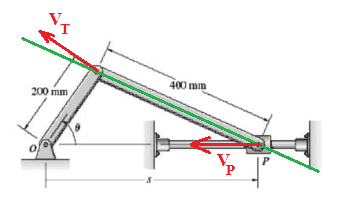

You might consider a different approach. Consider the diagram below. The green line is a reference line drawn along the 400 mm rod.
The 400 mm rod cannot change its length. So, what does this constraint tell you about the projections of VT and Vp along the green line?

The key is to consider velocities along the line of the arm connected to P.
Call the joint at the top Q. What can you say about the instantaneous relative motions of P and Q in the PQ direction?

TSny said:
Using the law of cosines to determine s in terms of θ and then using that to find Vp should work. But it's somewhat tedious.
It's saying that THE PROJECTIONS of Vp and Vt are changing at the same rate
