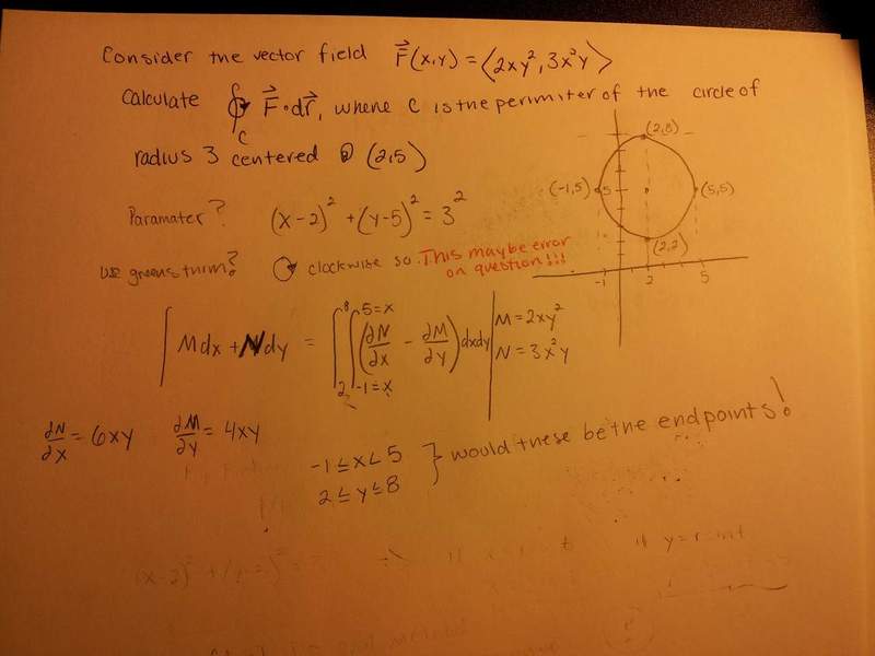

The problem is attached with my work so far.
Consider the vector Field F, where C is the perimeter of the circle of radius 3 centered at (2,5)
∫ Mdx+Ndy----->∫∫ (∂N/∂x)-(∂M/∂y) da
Attached is my work thus far. I am having trouble figuring out how to answer this question. I know that I cannot find a potential function f: ∇f=F because ∂M/∂y ≠ ∂N/∂x so i am assuming I could use greens thrm or another method in which i would just do ∫F(r(t)) (dot) (dr/dt)*(dt) (attached second picture) but i am unsure if I parametrized the circle correctly.
Any help would be greatly appreciated. Also I am unable to find a similar question in my textbook, if anyone can point me in the right direction to a similar problem that would also be great.
thank you

It would help if you would give a complete statement of the problem.
It's kinda/sorta given in one of your attachments.
##\displaystyle \oint_{C} (N\, \mathrm{d}x + M\, \mathrm{d}y) = \iint_{D} \left(\frac{\partial M}{\partial x} - \frac{\partial N}{\partial y}\right)\, \mathrm{d}x\, \mathrm{d}y \ ## is for the case where path C is taken counter-clockwise. It line integral for a clockwise path is the negative of this.
Doing the area integral should be easy. Define the region of integration.
You have the equation of the circle: [itex]\displaystyle \ (x-2)^2+(y-5)^2=9 \ .\[/itex] Solve that for x or y, depending upon which integral you want to integrate over first.

Thank you for the reply, I greatly appreciate it.
Maybe I misunderstood you, the question is stated word for word in the first sentence of the first attachment.
As for solving the area integral. I am trying to understand if I can put everything in terms of one variable t. So i do not have to solve y=5+(9-(x-2)^(2))^(1/2) or y=5-(9-(x-2)^(2))^(1/2)
or can i just list the end points as -1<x<5 and 2<y<8 or is there is a different method. as i stated, if you know of any similar questions that has a circle that is not centered at the orgin, i would greatly appreciate it.
thank you

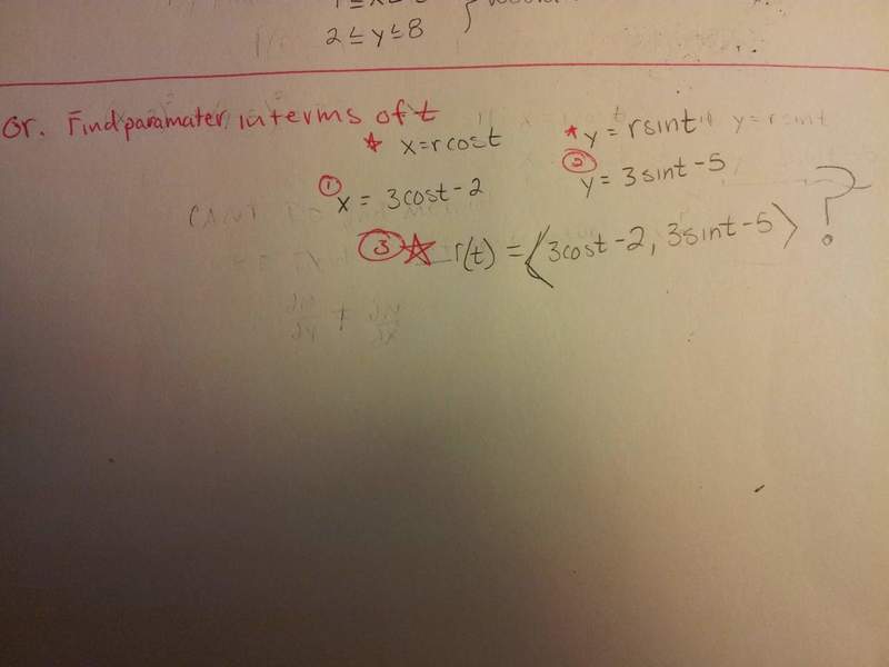

okay so if i use the first definition ∫Ndx+Mdy in terms of t i get
∫ ((cost)^(2))*(sint)^(2)) from 0 to 2pi

If you solve for y, as you are doing, then that indicates that you integrate with respect to y first, then with respect to x.
If you merely do the following ##\displaystyle \ \int_{-1}^{5} \int_{2}^{8} \left(\frac{\partial M}{\partial x} - \frac{\partial N}{\partial y}\right)\, \mathrm{d}y\, \mathrm{d}x\,,\ ## then you would be integrating over the entire rectangle -1<x<5 and 2<y<8 .
You need the limits of integration for y to go from the lower semi-circle to upper semi-circle.
For one thing, you do not show what your variable of integration is --- you have no dt .
For another, that integral is counter-clockwise.
Most importantly: How do you get that from the original problem ?

That is what I was asking, if i can parametrize the entire thing in terms of one variable t, as we are taught in the textbook. so if we have the equation
(x-2)^(2) + (y-5)^(2)=9 and we know that x=rcost and y=rsint as a asked can we put
(3cost-2)^(2) +(3sint-5)^(2)=9
i do not think you are going to use x and y, i believe you are going to use t OR theta and convert into polar integral form. this problem should have taken less than 5 min to solve, and if the equation for y=5+(9-(x-2)^(2))^(1/2) or y=5-(9-(x-2)^(2))^(1/2) that would take a lot of time and i know that that is not right.

Yes, this could likely be done in five minutes ... if you do the area integral.
That's the integral on the right-hand side of ## \displaystyle \oint_{C} (N\, \mathrm{d}x + M\, \mathrm{d}y) = \iint_{D} \left(\frac{\partial M}{\partial x} - \frac{\partial N}{\partial y}\right)\, \mathrm{d}x\, \mathrm{d}y \ . ##
The only issue you seemed to have with that was determining the limits of integration for the inner integral.
More on that later .
Since you seemed to be determined to do the problem directly, by doing line integral on the left-hand side of the above, I indicated that what you had done in attempting that
∫ ((cost)^(2))*(sint)^(2))dt from 0 to 2pi​
was not correct. What I didn't say was that it appears to be completely missing the vector valued function, F(x,y) .
If you want to pursue this method, let me know and I'll try to help.
However, my recomendation is to evaluate the area integral ## \displaystyle \ \int_{-1}^{5} \int_\text{Lower}^\text{Upper} \left(\frac{\partial M}{\partial x} - \frac{\partial N}{\partial y}\right)\, \mathrm{d}y\, \mathrm{d}x\,,\ ##
where "Lower" means the lower half of the circle and "Upper" means the upper half of the circle. You have already solved for equations corresponding to Upper and Lower portions of the circle.
You have done double and triple integral previously, haven't you?

Thank you for the help, in terms of y I do not know how to do it w/o making it complicated, but...
∫ <(2((2+cosθ)(5+3cosθ)^(2)) , (3((2+cosθ)^(2)*(5+3cosθ))> (dot) <-3sinθ,3cosθ> dθ from 0 to 2pi
again thank you for the help.
The equation, which you gave for the lower half of the circle is
## y = 5-\sqrt{9-(x-2)^2} ##​
For the upper half we have
## y = 5+\sqrt{9-(x-2)^2} ##​
Those are the limits of integration for y.
The integrand is (∂N/∂x - ∂M/∂y) = 2xy .

You can do the area integral (double integral) in polar coordinates.
1.
Shift your coordinate system so that you translate the point (2,5) to the origin. Then use standard polar coordinates.
Don't forget to alter the integrand appropriately.
2.
Use "Modified polar coordinates".
Let ##\ x=2+r\cos(\theta)\ ## and ##\ y=5+r\sin(\theta)\ ##
