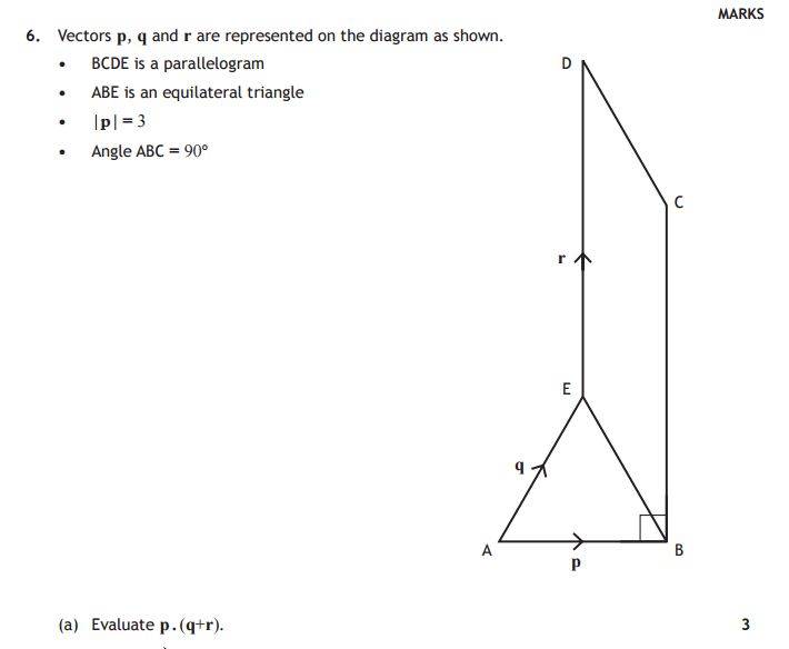

p.q+p.r
I've expanded p.(q+r) to give p.q+p.r. The magnitude of p is 3, and since ABE is an equilateral triangle, the magnitude of q is also 3, right? So then p.q=9, but the answer scheme states that p.q=4.5.
I'm still pretty new to mathematics, so I'm probably missing something really obvious, but it's better to make the mistakes now than in my exam!
CheesyPeeps said:
p.q+p.r
p.q is certainly not equal to 9.
Maybe you could start by stating the geometric definition of the dot product in Euclidean space, or ##\mathbb R^3## in this case.
Then you will be able to deduce from that the values of p.q and p.r
Ah, I've got it now. Thanks for your help!
