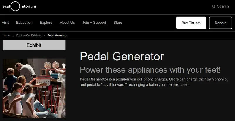

russ_watters said:
Btw, you can buy or make a cheap hand crank generator to see for yourself how much effort it takes to run a small load and how much the effort changes under load.
Yeah, on a visit to the Exploratorium in San Francisco with my kids a number of years ago, they had a great exhibit with a bicycle crank and pedals and various AC Mains loads that you could connect in (like light bulbs of different wattages, etc.). It was a great demonstration of what you can generate with your most efficient human mechanism (bicycling). I did not last long driving the 100W lightbulb, IIRC. :smile:
https://www.exploratorium.edu/exhibits/pedal-generator
