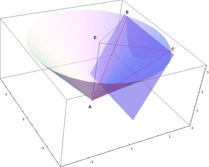

Here is the animation I was working on. The two luminous objects are joined by a tether and are exactly opposite each other at all time according to an observer at the centre of their orbit. The animation is the view of an observer seeing the objects orbit edge from a distance of 4 units which compares to a radius of one unit for the orbit of the objects. The objects have a tangential velocity of 0.785c in this example. On the left of the animation the objects are coming towards the observer and appear to be moving much faster than when they are on the right of the line of sight joining the observer to the centre of the orbiting pair. It can also be seen that the objects eclipse each far to the right of centre on the receding side of the orbit. Note that the animation only demonstrates visual size and does not take redshift of the light wavelength or changes in apparent brightness into account. All these visual effects are a simple result of regular Newtonian optics and finite light travel times. Relativistic time dilation and length contraction play no part in the apparent size of the objects. In the animation the objects pause briefly and are coloured blue to mark the time when a line connecting the two objects is exactly perpendicular to the observers's line of sight. At this point the objects appear the same size. This is just how I see it from my calculations (and a bit of light ray tracing geometry) but it probably does not answer the questions you have raised. I will come back to those.
Here is my reasoning:
The time when the center of the star is maximum blue shift is when it's motion fastest toward the observer, which will be when its motion is tangent to the line of sight on the approach. At this point, it will have been moving at near constant speed and near constant direction for hours (given e.g. pluto orbit size and 5 or 10 light years away). The light from the edges of the star won't reach Earth at the same time as the light from the center. The perceived edge of the disc when the center is at maximum blue shift will be from light emitted earlier, thus farther away, thus subtending a smaller angle.
The reverse argument establishes my claim for the redshift side.
I don't see any way out of this reasoning.
The effect I described above (light arrival time from limb versus center of star) is very small. The more significant issue is whether relativistic aberration applies to this example. yuiop is saying it doesn't, even in the non-orbital case. I think he is right and propose a really simple justification.
Re-reading derivations of relativistic aberration, it's root cause seems to be conversion from rest frame of source(s) to rest frame of rapidly moving observer. If you are already describing things in terms of distances and angles seen by the observer, there appears to be no need to adjust for motion of the source. Though it seems, at first glance, a counter-intuitive asymmetry, I think it is true that the star (in our example) will see the Earth small when approaching and big when receding, but the Earth observer will see no such thing about the star. yuiop alluded to this, but I thought he was referring to the fact that one frame was inertial and the other wasn't. Actually that is irrelevant; the star in a large orbit may be treated as inertial over very substantial distances and times. The difference boils down to whether or not you are translating measurements made in one frame to a different frame. If you are, then you get the aberration effect; if not, you don't.
So this is a major correction to my initial list. Hopefully, we will avoid spreading this confusion to other threads, in the future (as has happened in the past).

I'd like to understand and verify beaming (or what I think you're calling beaming) fully. I made a diagram that may help. Using the diagram attached, say we have a light source traveling along the line AD. The light is falling on on the screen at BC.
The angle in the source-reference-frame is BDC. But the angle in the screen reference frame is not BDC, because D would no longer be simultaneous with BC. We could call the BC-simultaneous event D', and find the angle BD'C, for instance, and then carefully check the assumptions about angles and intensity.
The way I did it my diagram was to Lorentz transform paths, then measure angles. Thus write the equations for two light paths separated by angle alpha in the emitter frame, transform to receiver frame and then compute the angle between the paths. For small alpha in the emitter frame, with emitter *approaching* receiver at speed v, I get receiver frame angle of alpha*sqrt ((1-v/c)/(1+v/c)) . Thus the 'concentration factor' approaches infinite as v approaches c.
