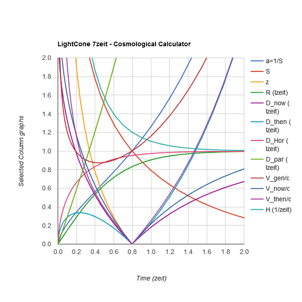

The LightCone7 cosmological calculator has been under collaboratively development on this forum for over three years now. It has sprouted a branch following Marcus' definition of a 'natural timescale of the present universe' - the long term Hubble time, which we collaboratively labelled one "zeit". So there are presently two versions: LightCone7s (for 'standard'), which is also linked to simply as LightCone7, and then LightCone7zeit. They are presently in a few signatures around here.

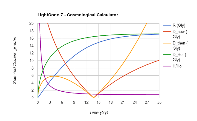

LightCone7 is essentially a table-making calculator, but one of the great features that emerged is a charting option. It has a predefined set of 12 curves, which can be selected for inclusion in the table or chart. What LightCone7zeit taught us is that the degree of normalization resulting from using zeit and light-zeit units is very useful when comparing different graphs with each other. The normal values of cosmological parameters in their usual units have widely different scales.
Just for illustrating the point that I want to make (and without claiming any usefulness for the full set of graphs), here are the whole lot in one chart. Apart from the light-green D_particle graph, all the others have comparable normalized magnitudes over a very useful range of time.
Despite the naturalness of the zeit timescale in cosmological terms, it has a certain "unnatural" ring in human terms, e.g. the present cosmological time is about 0.8 zeit and the present Hubble radius R is 0.83 lzeit.

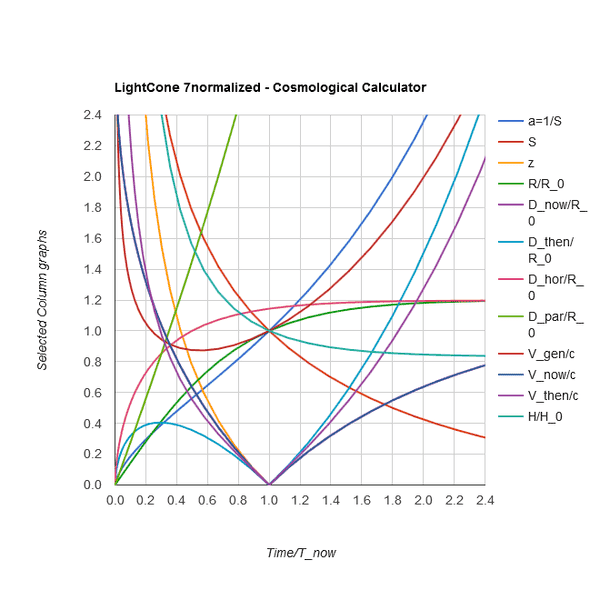

I experimented a little with other normalization values and found that the present Hubble radius (R_0) and the present cosmological time (T_now) 'looks more natural', to me at least.
I'm aware of the fact that this destroys some of the mathematical simplicity of the zeit-scale normalization, but I would like to know other opinions on it.

My first reaction was favorable. It seems like it could be a useful alternative. In effect what it does is use the present age (Tnow) as the unit of time, and the present rate of expansion H0 as the unit rate, to which other rates of expansion can be compared. That seems natural and intuitive. I just now saw the new version of Lightcone for the first time, so I'm just beginning to imagine situations where it might be especially helpful.
A newcomer to cosmology might find comparing past rates with the present more meaningful than comparing percentages per million years. For example someone might wonder when was the expansion rate TWICE what it is today?
and then looking back at the graph of normalized-Lightcone, at the light turquoise H/H0 curve, one sees that ratio was 2 at an age about 0.4 of the present age.

I have to say I was never really fond of the zeit scale. I understand how it's a mathematically 'sensible' normalisation, but it always felt like yet another mental hurdle to overcome as one struggles to imagine what's going on - a natural tendency for the mind, mine at least, is to view the history of the expansion from some manageable mental anchor point, like the universe at the present day.
In my opinion, any normalisation that takes present values for its basis is going to be more palatable for anybody who is not already an advanced student of the subject.
So yeah, I do like the new approach.
Of course, in the end we want all of them to be available - the original not normalised one, the new scale, and the zeit one too. Same as with the three lightcone graphs with different scaling Lineweaver & Davies employed in their oft-cited paper, the more ways there are to help form a mental picture of the expansion, the better.
