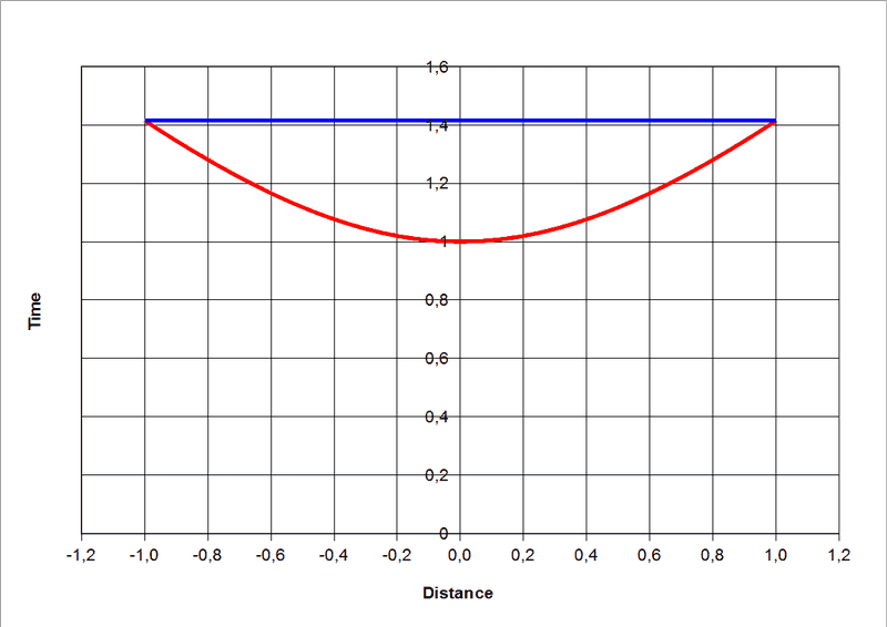

Ok, here's more on the difference between both.
Here, I use again the empty universe - the Milne model - as the best toy model. If you're not familiar with it: it's basically the empty "expanding" universe expressed in Minkowski coordinates. There are good places to get familiar with it, Ned Wright's website not the least.
Assume there's an inertial observer at coordinate position zero. We pick a spherical shell of events that happen all at cosmological time 1 (arbitrary units) in a cosmological distance 0.88 (there's some meaning to that number). We first drop y and z and concentrate on a t,x spacetime diagram.
So, what's the difference between normal and CPD definitions? Here's a graph in Minkowski coordinates: (ok sorry, it seems the graph is visible in the attachment only)
https://www.physicsforums.com/attachment.php?attachmentid=47411&stc=1&d=1337373065
The normal definition (blue line) is of course a straight line connecting the events at observer time 1.41. Their mutual distance in this system is 2, their distance to the observer is 1.
So in normal coordinates the events happened at time 1.41 in a distance of 1.
The FRW definition is a line of constant cosmological time = constant proper time of objects since the Big Bang. Such a line is obviously a hyperbola here, as [itex]t^2 = tau^2+x^2.[/itex] Hyperbolae are not geodesics of empty space, therefore the distance to the origin is different: 0.88, as said before.
In FRW coordinates, the events happened (as stated) at observer time 1 in a distance of 0.88.
Operationally, the difference is due to the comoving - not stationary - rulers used here: they see all distances Lorentz-contracted, therefore yielding a lower total distance.
There's an interesting consequence: a circle at Minkowski radius 1 has obviously a diameter of 2π. As the FRW rulers that measure circumference are oriented perpendicular to their motion, they'll also measure a circumference of 2π - but here with a radius of 0.88!
This imbalance between diameter and circumference translates directly to a negative curvature of space in comoving coordinates. With the help of Wikipedia, one can (relatively) easily calculate the curvature: it is -H².
So in FRW coordinates, we'd have to expect space curvature by the matter content of the universe, and additionaly a negative contribution from the moving rulers we're using. Which is in fact the case, here's the respective Friedmann equation rearranged:
[tex]\frac{k^2}{a^2} = \frac{8 \pi G \rho}{3} - H^2[/tex]
We see: energy content curves space positively, while expressing it in comoving coordinates curves it negatively. An equilibrium of both is called "flat space" in the cosmological models, which is not at all a flat spacetime.
  • Minkowski spacetime diagram with Time on the vertical axis and Distance on the horizontal axis, both running from -1.2 to 1.2. A straight blue horizontal line joins two points at distance -1 and 1 at time about 1.41. A red U-shaped curve, lowest at distance 0 and time 1, connects the same two endpoints.
Ich said:
Sorry, I can't follow you here. Are you claiming that geodesics of FRW space are spacetime geodesics?
Also, the concept of "stationarity" you're using strikes me as odd. A general FRW spacetime is definitely not stationary, and even in the cases that are (empty and de Sitter, let's ignore the Einstein Universe), FRW space does generally not contain any spacetime geodesics.
What is stationary is a particular set of observers with respect to the coordinate system. Those observers roughly correspond to real observers on real galaxies (not exactly, since real galaxies tend to move at a few hundred to a couple thousand km/s with respect to the coordinate system).
The critical point to be made here, however, is that the choice of proper distance is always going to be arbitrary: it depends entirely upon your choice of observer worldlines. With your Milne example, for instance, you haven't picked the same set of observers between the Milne space-time and the flat space-time: in the flat space-time, the stationary observers in the Milne space-time are no longer stationary, so you have to take their motions into account.
I think you're confusing some things here.
"Stationary observers" can be connected by an orthogonal spacelike geodesic. The worldlines of those observers are integral lines of the timelike Killing field in a stationary spacetime.
Observers at a constant spatial coordinate in a time-dependent, non-stationary coordinate system (like FRW coordinates) are guaranteed not to meet that definition. The orthogonal line connecting them is never a spacetime geodesic.
Which is exactly my point. Choosing a different set of canonical observers, namely comoving instead of static ones, produces a different distance measure. As shown by the red and blue lines in the diagram. I didn't understand your "Well, no, they're exactly the same." in that context, as they clearly are not.
The Milne spacetime is flat, independent of its coordinate representation - Minkowski or FRW. If you wanted to say "canonical FRW observers are not at rest in Minkowski coordinates", that's true. It's also true that I chose different sets of observers, according to the respective coordinate representation. That's exactly what I have written, so I don't understand your former statement when you're now obviously agreeing.
So it's safe to say that you no longer claim that both definitions are the same?

The thing is, stationary is a matter of perspective.
Perhaps you are simply using "proper distance" as the term is used in Special Relativity. But that definition clearly doesn't work in a curved space-time. But the generalization of this definition to the cosmological definition is easy to understand: if we define a set of observers at every point, then the proper distance is a space-time geodesic which is orthogonal to those observers' word lines at every point.
But since this definition allows us to define a global time coordinate, a geodesic defined in this manner is always going to be independent of time, and therefore just a spatial geodesic. That fact is due to our specific coordinate choice, but the proper distance we obtain would be the same in any coordinate system provided we make the same choice of a set of observers.
