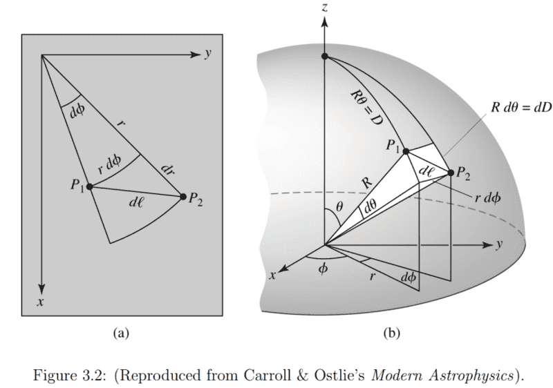

If we consider a time variance in FLRW metric, how can we visualize an emitter (having proper time) in the 4D spacetime geometry?

Please refer to the image below to visualize the 4D spacetime geometry used to derive the metric.

In the 4D visualization, where is actually the observer placed? In one of the two spacetime events P1 or P2 ? Not in the center of the geometry.
Accordingly, does the proper time
refer to an event occurring, for instance, in P2 with respect to the observer, if placed in P1?
In this case, P2 emits the signal which is received by P1.
Well, the two visualisations are of 2d spatial slices embedded into a (purely invented) 3d space. Accordingly there may be observers at any location. Furthermore, the lines marked ##dl## are spatial displacements, so don't correspond to any interval of proper time at all - they are spacelike paths.
There are no signals represented in those diagrams.

Are basically observer and emitter associated to P1 and P2 (see original picture I posted). Thank you!
All points in space are completely equivalent. This is what homogeneity means. You can therefore pick any two points as long as they have the correct comoving distance between them. Of course, some choices (such as placing emitter or observer at r=0) makes life easier than others.
If there is a particular observer of interest (which is not necessary) then you would typically place them in the center. I am unsure why you would say “not in the center”. The center is arbitrary and any point can be selected as such.
