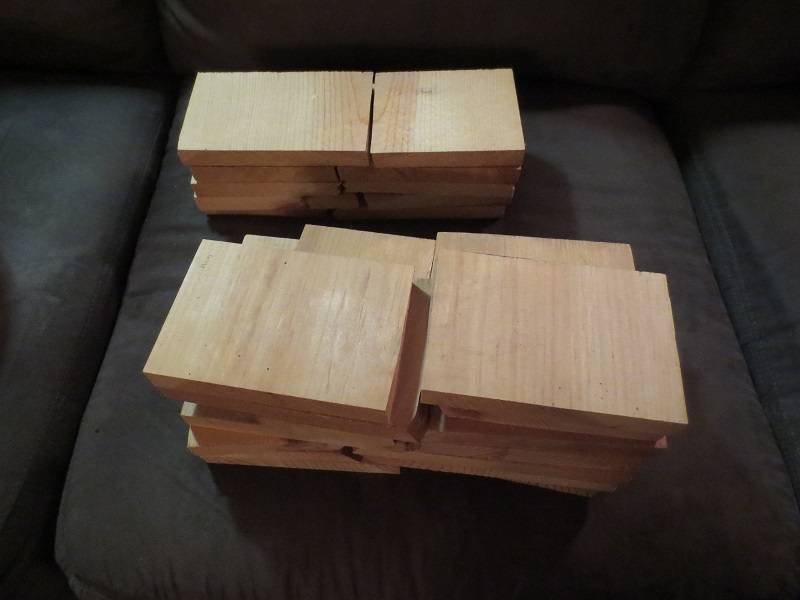

"That sounds more like an inaccurate punch than an inaccurate measurement to me."
Well, I kept some of the boards she broke:
dlgoff said:
She could break 4 boards stacked together with one fist punch.
Is this the same dainty daughter who likes flying planes upside down?

No. I said she had to be accurate. Meaning, she had to hit right in the center of the four boards. I saved a few of the boards she broke:
That, and hitting hard enough while using her hand correctly. I once spent a fun afternoon showing friends how to punch out windows in an abandoned building that was being demolished. Hit (leather gloves required) hard enough with the correct knuckle, and the window shattered with no pain on my part. Hit not quite hard enough, or with the hand slightly out of position, resulted in pain and an unbroken window.
Yes, and you'll notice that all the boards are broken WITH the grain, which is actually pretty easy. The test is if you can break even one board across the grain. You are right, of course that she had to hit at or near the center to get maximum leverage on the board.
As far as I'm aware, no martial arts board breaking is every done across the grain.

They don't have any grain direction. I'm not suggesting that martial arts breaking of stuff is fake or anything, just that wooden breaks are always with the grain.
When I took Tae Kwan Do about 100 years ago, I brought home some of the pine boards to show my kid. I broke three stacked together (supported at both ends but not in the middle) and he was impressed.
Then I took the one I had put aside, which I could tell was the weakest of the lot, and I broke it just by gripping my fingers over the edges and then pressing the center with my thumbs. I am not particularly strong. I was showing him how pine boards break with the grain very easily.
Then I took one of my own that I had cut to the same length as the others but with the grain running along the length, not cross-grain, and smashed it in the center with a sledge mallet and all I did was dent it.
My lesson for him was not about martial arts, it was a graphic demonstration of the differences in wood strength across the grain and with the grain.
