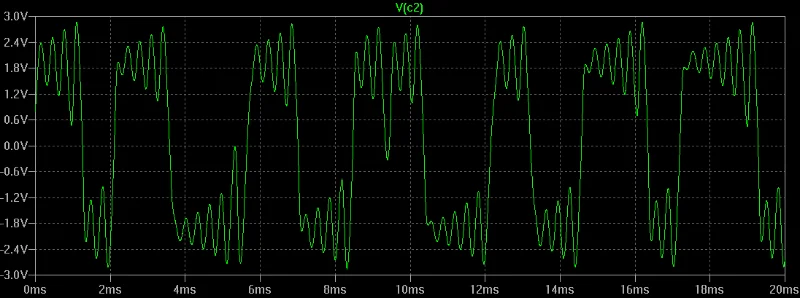

Here is a simulation in LTspice using real electronic components.
sophiecentaur said:
Could you drop one of those on your foot?
Yes. Every component part is available commercially, so you can build it, and it will work. There are no tricks being performed by LTspice with controlled sources to synthesise Chua's diodes.

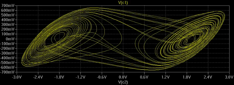

There are two attractors, at V2 = ±1.8 volts. As the signal is amplified by the local gain, the oscillator signal orbits that attractor, until the phasor reaches an amplitude where it can escape across the saddle near zero volts, to the other attractor. While crossing the saddle, the phasor is attenuated, whereupon the process is repeated, each time with a different escape velocity and attenuation. Notice how the first cycle of the phasor has a different amplitude each time, and that there are occasions when it fails to complete the saddle crossing.
Is the energy dissipated, or is the energy transferred to another element than the one whose voltage is plotted?
I am not sure. It may be dissipated in the linear resistor between the two capacitors, or it could be invested, regenerated in Chua's non-linear diode, which appears as a negative resistance amplifier, obviously with a power supply capable of absorbing energy.
To keep it conceptually simple, I did only plot the C2 component of the phasor. If you run the simulation, you can plot the power dissipated in the linear resistor.

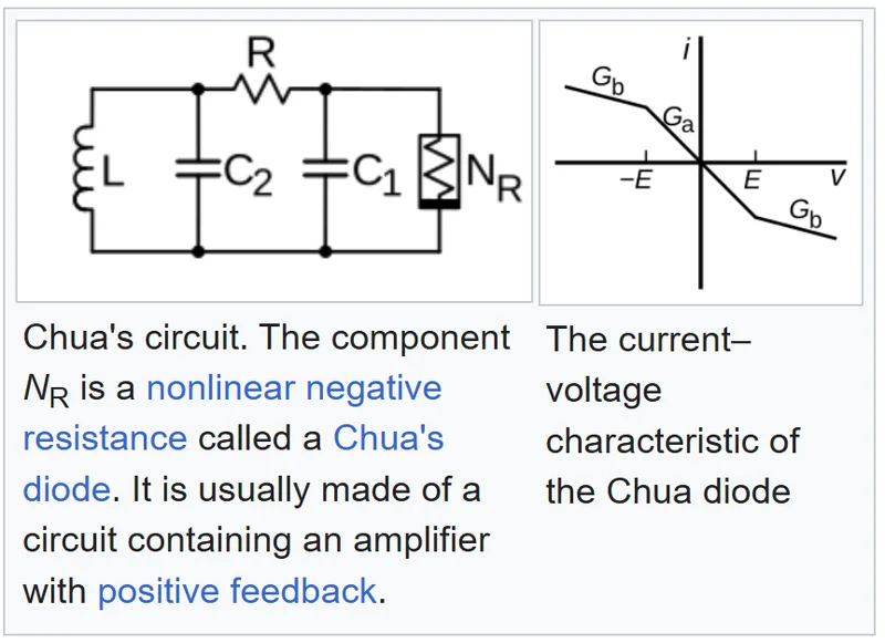

In the ideal circuit model:
The only element that can dissipate energy is the resistor. The negative resistor (Chua diode) can only produce energy. These must be in balance on average for the oscillation be bounded and sustain itself. But clearly they both vary chaotically throughout the cycles. Dissipation will be highest when the cap voltages are different; the upper left or lower right areas of @Baluncore's phase plot above. Likewise, energy is input in proportion to C1's voltage, which is only zero momentarily.
Stored energy is always moving around between the reactive elements, of course.

There is no "spike" applied. A spike could simply be programmed in LTspice, even to occur pseudo randomly with some statistical distribution, but it is simply not needed here.
Look at the plot in post #7, follow the line. There is no spike needed to switch between attractors, it is part of a simple trajectory. The point is like a ball rolling on a curved surface, a saddle, that separates two gravity wells.
Swamp Thing said:
And my impression is that the transitions are not triggered by random events, but rather have to do with the re-growing oscillation reaching some threshold. Classic 'pump and dump'.
The "pump" acceleration and "dump" deceleration is gently applied to the ball, or point, in different regions, regions defined by the profile of Chua's diode.
This model can be seen in the light of the unpredictable three body problem. The point is like a satellite, being thrown around in the vicinity of two attractor planets.
