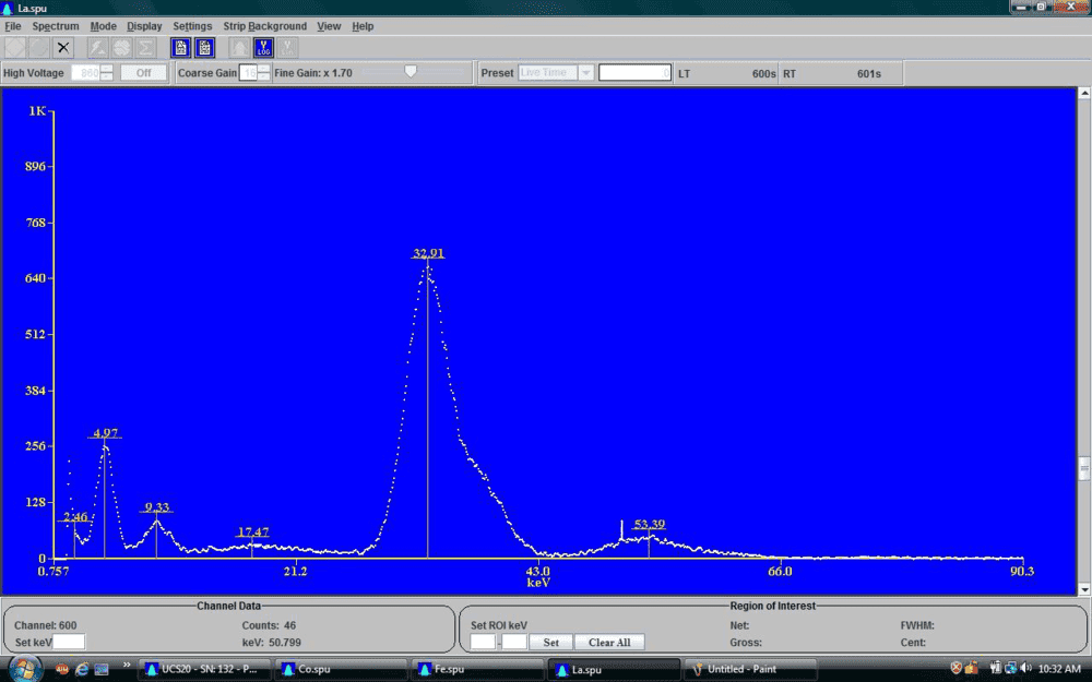

Hello!
I've got an gamma/x-ray NaI(Tl) Scintillator. It has a positive going signal design (Hamamatsu photomultiplier tube plus preamplifier).
I want to acquire its raw signal by a 250 MHZ digital oscilloscope and to process the signal myself using scientific programming.
What are the options for callibration? Please advice different approaches, cheap and more sophisticated ones.
Thanks in advance for your help.
What will be the source of your signal and how do you want to process it?
I need one or more known and pure frequency signals for the calibration, so that I can map the electrical output signal of scintillator to them. The calibration signals could be either be gamma or x-ray. Ideally I need one gamma ray and one x-ray signal as calibration signals.
I assume by your use of the term pure frequency you mean a gamma/x-ray of known energy. What range of energies do you want?
Low gamma and medium x-ray frequences. The exact frequence does not matter, as far they are pure and unmixed.

Is there a possibility to use an electrical generated x-ray for calibration, e.g. from an x-ray tube?

No and Yes . The x-rays produced by and x-ray machine are mostly continuous in energy with the maximum energy equal to the Voltage used to produce them. That voltage can be well controlled but the yield of those x-rays is very low compared to the lower energy x-rays which will swamp the detector. So using an xray machine directly is out.
When elements are exposed to to x-rays of high enough energy the radiation excites atomic electron to higher energy levels which then decay producing what are know as characteristic x-rays which are monoenergetic. These have well known energies. An elemental analysis technique known as X-ray Fluorescence Spectrometry detects various heavy elements by the presence of their characteristic x-rays. A sample of material is irradiated with a source of radiation whose energy is greater than that of the characteristic radiation being detected. Check this article for a much better idea of how this might be used to calibrate your detector https://xrf-spectroscopy.com/

This xrf-setup sounds pretty perfect to me. Among others I have got a little 99,99% palladium bar, which I could use for it. The wavelength of Pd is statet 0.05859 nm in https://en.wikipedia.org/wiki/X-ray_fluorescence.
So are there special requirements for an xrf-tube?
Are there complete xrf-boxes, that shield the x-ray and in which I can mount my scintillator for calibration?
You usually like to have at least two calibration points. The energy of the Pd x-rays is about 21 keV pretty low but I do not know for what you will be using your detector. The highest energy X-rays and yield from Lead are about 88 keV. To excite the characteristic radiation you need your x-ray unit set higher than the characteristic radiation and the higher the better up to a point because you will also be producing more extraneous radiation that will obscure the radiation you desire to see.

I do not know but using the link I gave you should be able to make one fairly easily. Important points to remember are shield the X-ray source you are using extremely well to avoid its radiation getting into you detector directly, collimate the x-ray beam well so that the radiation only strikes the sample you are irradiating.I still am not sure how you will be analyzing the signals from the detector. Could you supply more information? This might be very important.
I've done XRF and it's quite noisy - most of the x-rays are not from fluorescence. That makes it not very good for calibration. Also, NaI is typically used for 10-100x these energies which means a) your resolution is terrible (30% or so) and b) any non-linearity will be difficult to see.

Home made XRF from Lanthanum on sodium iodide (Tl)
