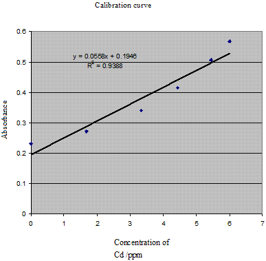

The concentration of cadmium in seawater can be determind spectrophotometrically. To six 50.0mL seawater samples, various volumes of a 10.0ppm cadmium solution were added and all were taken through the analytical procedure with the following results:

Construct a standard addition calibration plot using EXCEL and calculate [Cd] in seawater in ppm (µg)/mL.\

Calculating concentrations is just about dilution. Amount of substance in the sample doesn't change (principle of mass conservation), what changes is the volume. Calculate initial amount of Cd in the solution that was added, divide that by final volume (50 mL of sea water + volume of Cd solution) - and you have a concentration. This will give you a series of data points - absorbance (given) vs concentration (calculated).

Once you have data points, you can easily determine the slope. Note that if you have a calibration curve you don't have to worry about molar absorptivity nor cell length - all you need are coefficients in the equation absorbance = k*C + intercept (hopefully intercept will equal 0, making it even simpler).

Yes, the last section about the need for εb is wrong. That is - it is correct as a part of general case, but here you don't need to know them separately. There is enough information to determine Cd concentration, assuming you will use the same cuvette, the same spectrophotometer and the same procedure.
Okay great. So I just have a couple more questions...how do I go about finding the slope of the line? And since that last section is wrong, how would I determine Cd concentration?
Slope for the data set - with Excel. Don't ask me why, search the help for linear regression or something similar.
After you do linear regression you will know values of slope and intercept:
absorbance = slope*concentration + intercept
(hopefully intercept value will be zero or close to zero). Solve this equation for concentration - and all you will have to do will be to just plug absorbance into the formula.

Coolio. X intercept or Y intercept
y = a*x + b, so y=b for x=0. y is absorbance, x is concentration.

Okay so is this correct?
y = 0.0558x + 0.1946
absorbance = 0.0558x * concentration + 0.1946
absorbance - 0.1946 = concentration
0.0558
So then I plug the value 0.230 for absorbance into this formula, and solve, getting 0.6344 ppm?
That would be a correct approach, no idea if these numbers are correct.
