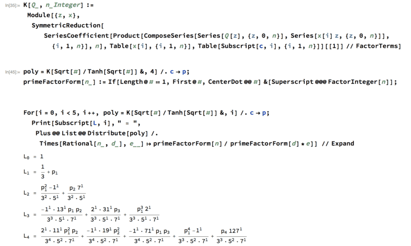

Hello! I am new to Mathematica and I need some help with the code I attached. Can someone tell me how to pull the variables out of the fraction i.e. instead of ##\frac{7 p_1 p_2}{2 \cdot 5}## I would like ##\frac{7 }{2 \cdot 5} p_1 p_2## (I need this to make it look better for when I import it to Latex). Also, is there a way to factor out the common denominator of all the fractions? Thank you (and I am sorry if the questions are trivial)!

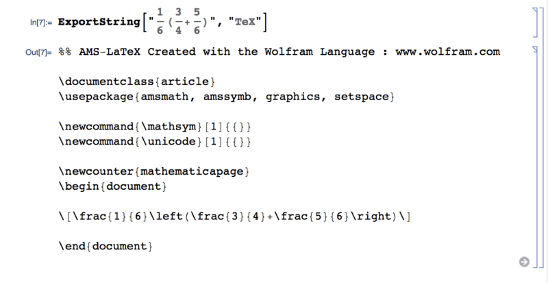

Sorry, I was hasty in my reply. I just stick the expression in ExportString bracketed with double quotation marks.
This
ExportString[1/6 (3/4 + 5/6), "TeX"]
will give you
\frac{19}{72}
but this
ExportString["1/6 (3/4 + 5/6)", "TeX"]
will give you
\frac{1}{6}\left(\frac{3}{4}+\frac{5}{6}\right)

Here is a screen shot of what I used for your example. I have not used this in a For loop. You may have to experiment a little bit to get it to do what you want. I assume you have gone to Mathematica Help and looked at TeX / Export.

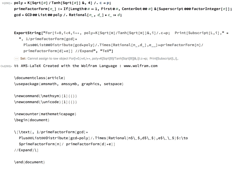

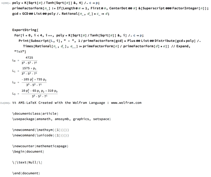

Yes it works with a simple expression like that, but now with what I have. I am not sure where to put the quotation marks for example... I attached a SS of what I get with and without quotation marks and it doesn't work

I don't know what you have and I have a vague idea of what you want to do, that's why I suggested that you read the Help documentation and experiment on your own. Maybe someone who is more knowledgeable in these matters can help you.
