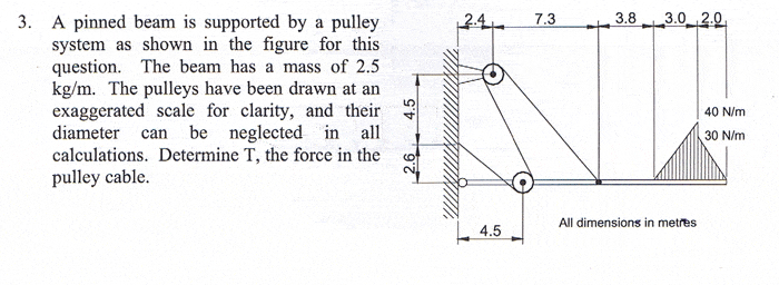

How to Solve a Pulley/Distributed Load Problem for an Engineering Exam?
  • Thread starter Thread starter aaronjason
1 reply · 3K views · last reply
aaronjason
Hi there, I am new to this forum, and I need help doing a problem befor my engineering exam in a few days. It is a pulley/ Distributed load problem. I have attached an image with the actual question so yu can have a look at. Any help will be appreciated. Thanks a lot in advance!
You have to show your work.
I think the line of action of weight of the two right angled lamina will through their center of mass which are not midway.
