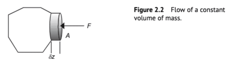

Consider the flow of a constant volume of mass (a closed system) into an open system as shown in the first figure below.
The initial energy of the closed system is ##(U+E_K+E_P)_i## and the final energy is ##(U+E_K+E_P)_f##.
The following is what is written in the book I am reading.
The energy required to "push" the mass into the system is
$$F\delta z=PA\delta z=PV\tag{1}$$
in which ##V## is the molar volume of the closed system, ##F## is the acting force, ##A## is the cross-sectional area, and ##\delta z## is the width of the system.
The necessary energy transferred across the boundaries of the open system is
$$E_{mt}=(U+E_K+E_P)_f=(U+E_K+E_P)_i+PV\tag{2}$$
and the net energy per mole caused by the mass transfer is
$$Net\ E_{mt}=\sum(U+PV+E_K+E_P)\tag{3}$$
To obtain the total net energy, multiply (3) by the total number of moles.
Finally we can collect all our energy transfer terms:
$$TRANS=\sum Q+\sum W+\sum (U+PV+E_K+E_P)_{mt}\tag{4}$$
My question is: how is (3) obtained?
