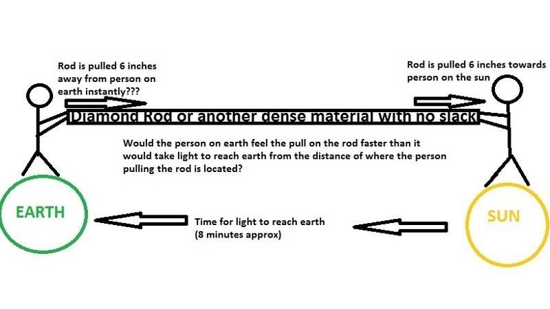

Thanks for your reply Davenn, I don't understand what you mean by pulse. Here is a picture I drew up to help explain it better:
The is no such thing as a perfectly rigid object. The other end of your diamond rod would always move at much less than light speed. The bulk modulus is the property that defines rigidity of an object. The bulk modulus of a diamond is only about twice that of aluminum.
Neutron stars represent the upper limit for rigidity of materials in the universe. In fact, limiting the speed of sound to c actually gives the basis for calculating the maximum theoretical mass of a neutron star - re: http://arxiv.org/abs/astro-ph/0011107

by pulse I mean, when the rod is pulled, pushed or hit at one end there is going to be a pulse of that motion that moves along the rod towards the other end.
even for a rigid material like diamond, over any significant distance, its still going to exhibit an elastic deformation along its length. This is something that is valid even when looking at the Earth as part of solid Earth geophysics, on a small scale rock acts very solid but on large scale it quite happily deforms elastically.
So when you pull on one end of your rod its going to produce an extensional elastic deformation (if pushed or hit it will produce a compressional pulse) that will travel as a pulse along the length of the rod
And I would suggest that the speed of that pulse is substantantially less than the speed of light.

BTW, that speed is the speed of sound.
